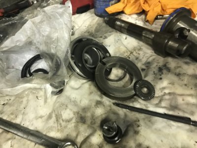

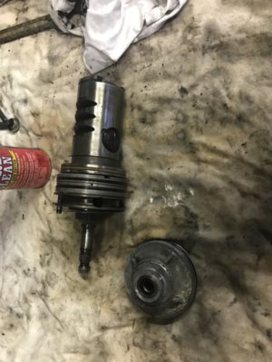

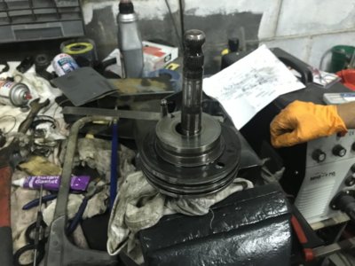

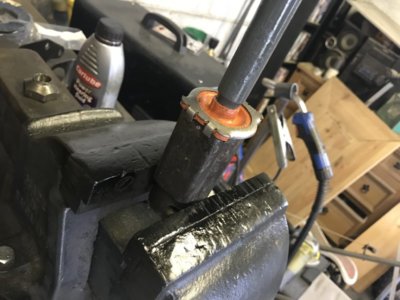

I just finished rebuilding mine with new seals and setting the lash on the bench. Not for the faint hearted.

3ACA2140-2901-469D-ABC8-11CA0340351A.jpeg 3E534C8C-D726-4EE5-9AF7-792A16AE22C5.jpeg EAC2329D-FA6A-4912-8FC0-38E77A023E99.jpeg B4192FD2-BAE1-41B0-8FC2-EFC22D6C64C0.jpeg
