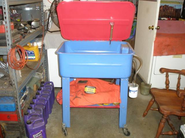

I use Orange citrus from HD. I use mine alot and have to change it twice a year. Works well in my HF washer I made heated. Easy to get rid of also since it is water based.
I use flash solvent 142. It has a higher flash point that mineral spirits. I have had this same solvent in my parts washing tank for over 30 years, never changed it. Still works as good as new. It is dirty. I just scrape the thick goop off of the bottom once in a while. To get the dirty residue off of the parts once all the heavy grease and dirt is removed I just give them a final spray with some brake cleaner.
I've been thinking about trying some kind of water based solvent just as you said because it is easily disposable. I can get rid of the TS stuff at the local recycle center for now but I think this will probably go away in the near future. Any tips on how you heated it?
240 watt hot water heater element. Works great on 110V
