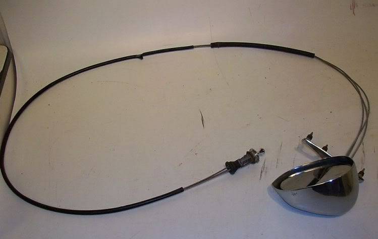

well, i picked up this for 25 bucks.
when I get a chance I will see how close it is to my factory drivers side mirror.
if it looks anywhere close, I will figure out how to mount, run the cable, and install the bezel, even if it is a non stock set up.

Sure are some long-assed cables for a door panel installation. As far as the mirror itself, mine [both sides] are mounted with phillips screws that go all the way thru the mirror, and into nuts welded to a retainer plate that is secured to the door itself by 2 more screws. The door will actually have 4 holes in it. I dont think the studs that you have are correct. Did you notice that?
I did not notice the mounting difference until after getting it.
The cable is long because it is supposed to go under the dash and mount where the driver can adjust it. I thought some Chargers were available with that and thought maybe RR's too.
I am now thinking it was another application. Got to get my other mirror out and compare and see how similar or not it is.
Maybe its a cordoba mirror or something.

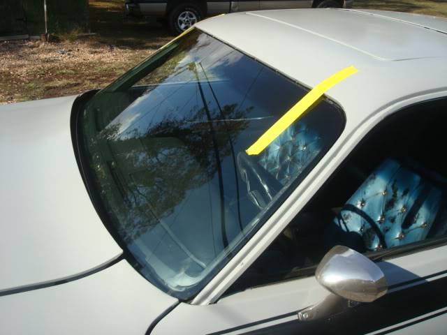

The mirror body itself looks right. Just the pedestal is different. If its not right for you, maybe you can find someone to trade with. Btw, did you still need pics for the sunroof drain locations?
I sure do need pics 74Birds.
It would help quite a bit knowing exactly where to put them.

That's the same one I have. Drilled holes in proper places, and still don't mount right.
I think the correct application had a hemispherical depression stamped in the door at each stud location.

I don't have any pics but what I did on my 72 charger was take the right mirror from a Aspen RT that looks just about like yours and used the guts in my 72 mirror. I took the head off and drilled a hole in the bottom of it by referencing my left remote mirror and ran the cables through it and made a" factory" remote mirror. It actually worked pretty slick. The hardest part was getting the glass out of the mirror. You can't get to the screw with the glass in it! I just broke the glass out and put a new mirror in it. The factory mounting hole for the Aspen was under the dash but it was a plain unchrome stem. I would say yours is for a door panel application and remenber the cordoba had a big door so by the time you route it around stuff , it needs to be long! It looks like you could just swap the heads but they are different. I think if factory engineers had made right remote mirrors they would have put the knob under the left side where the rear defog and other acc. were. Especially on a rallye dash!
