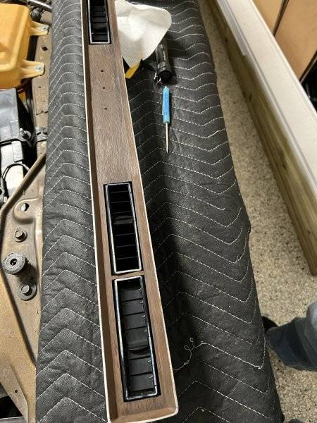

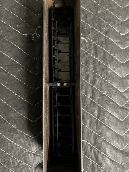

Has anyone done there own restoration on one of these simulated wood grain tri-vents? Specifically, removing and then successfully reinstalling the double vent? Was going to send it out for restoration until I got the quote which was just under $1200. I decided I would try myself. I can get the pins on either side of the vents out but its the middle bracket that I am unsure of. It looks like there are two small pins that hold a brace down. I can get the pins heads off by lightly grinding and then I'm guessing the brace will come off. Securing it back in place will be a challenge. Maybe a dab of epoxy at the pins would work? Any suggestion or experience would be appreciated.
Fantastic! That did the trick. Thanks very much. Was able to get the double vent out by moving the pin side to side. Doesn't move much but it was enough to get the vents outs. Hopefully they will go back in just as easy
