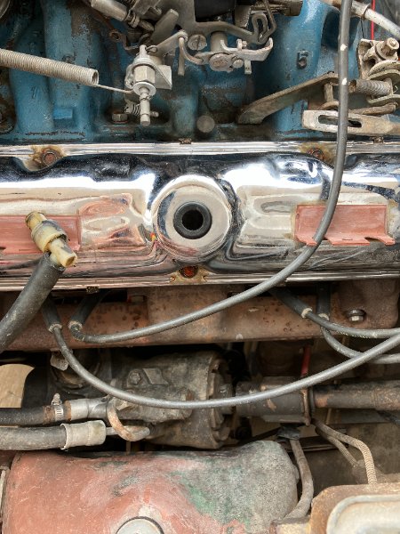

We don't have an "emmissions" forum category so I place my question here. I am using the old school Direct Connection chrome valve covers on the 340 build and the 1/2" PCV is loose in the rubber grommet hole. Looks like the hole is about 5/8". Anyone have a part number or source for a PCV that will fit good and snug? The hose from the Thermoquad is supposed to be 11/32" but I can worry about that later (adapt, etc.) Thank you.
Its hard to tell without measuring the hole size. If it measures 3/4 you can use one from a 78 ford truck.

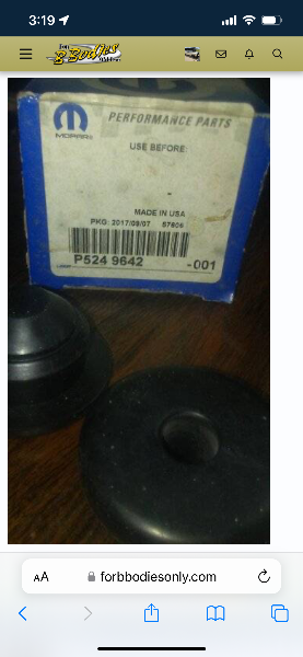

I think they still sell the larger grommets. There was a post on it I believe
Dibbins your in luck maybe l. Once again combing my saved files of mayhem this might help you
