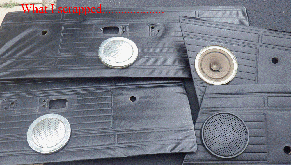

I used PUI for my door panels on my Road Runner. I just bought replacement Legendary door panels at Carlisle so I can get rid of the PUI. The PUI door panels have really weak pressboard material. After installation, if you ever try to pull them out again to fix something in your door, you are likely to rip out a few of the clips from the pressboard when you try to pry them out of the door. :mad: Yes, I was careful, but I still had some tear out. With the OEM door panels, you can rip those suckers off and on forever and they stay in decent shape.

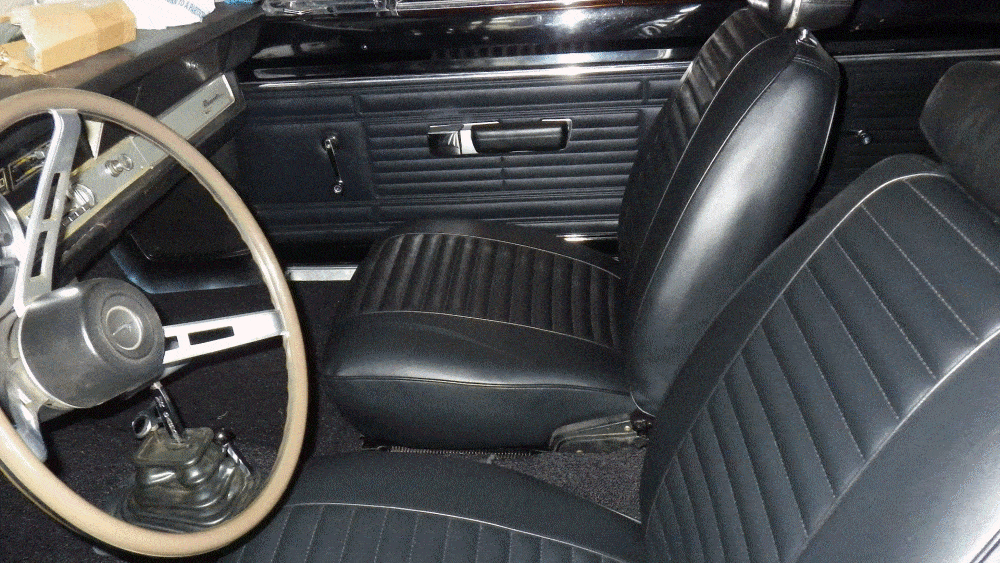

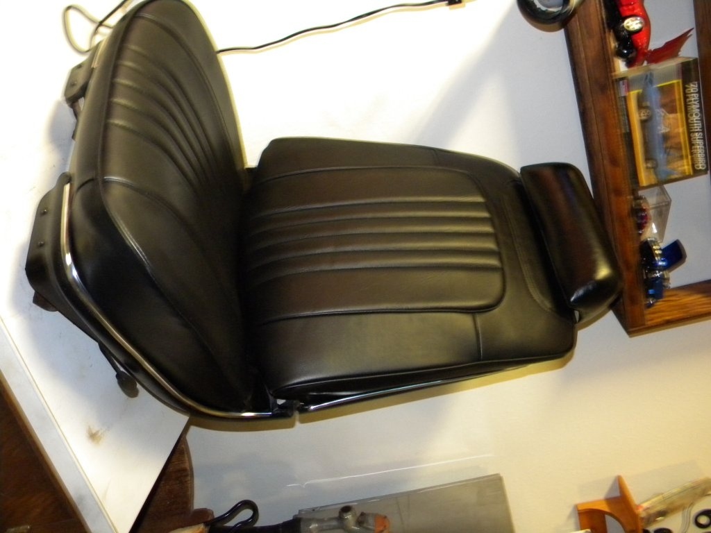

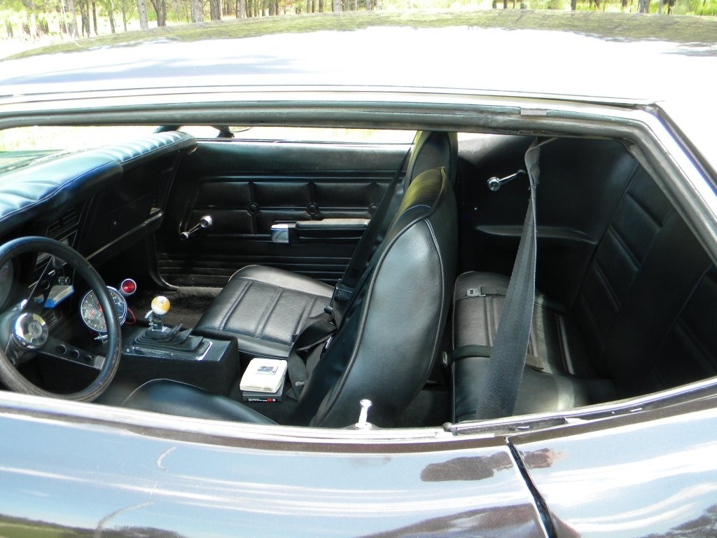

I would probably be ok if PG sold PUI. I myself have had pretty good luck with their stuff. I am not saying all of it is good but I haven't had any that was bad. The thing is I don't want junk in this car. But on the other hand PG Classics for all the parts I need are about 500 less than Legendary. For some reason 68 charger stuff is way more expensive than even my Super Bird stuff was. The first pictures below are PUI 71 Chevelle seats I did my self. The third is PUI on a 71 mustang I did about 5 years ago. Granted it don't get driven much but they are really holding up well.

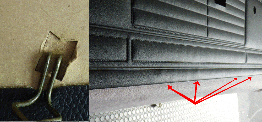

Yes they are pretty stiff, however..........

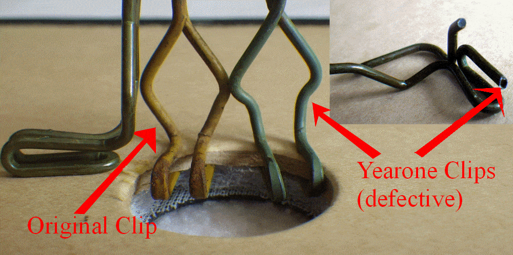

The set I got came with instructions to start poking around with a bent rod that has a flattened and sharpened end. You are supposed to dig out the perforated first layer (as I understood the directions) of the board and spread out in a fan shaped area to slip the clips in between two layers. Evidently it is intended to obscure the clip bumps on the face side. Ha, there was no definite division that indicated two layers in mine. So I tried to create two layers along the bottom line of clips with this "tool". What a pain to do and I noted these perforated areas run all the way through the board. The thicker padded areas I just dug it all out to the padding.
I bought some new YO clips. For the cost you'd think you'd get quality, but NOT! A couple were absolute s_it and I'll refer you to the pictures and let you decide. Suggestion: Don't toss any good originals.
