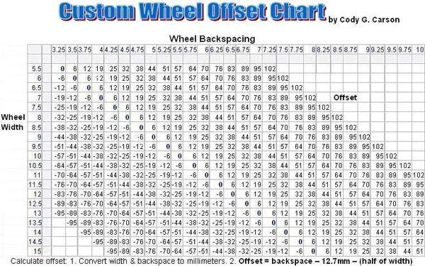

Here's a chart I had to convert backspace to offset.
