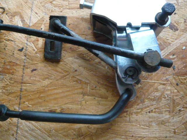

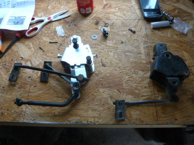

cant seem to find anything online. bought from Hurstshifters-Scotty- hurst comp plus and cant figure out how the reverse rod gos.thanks for any help.

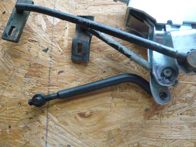

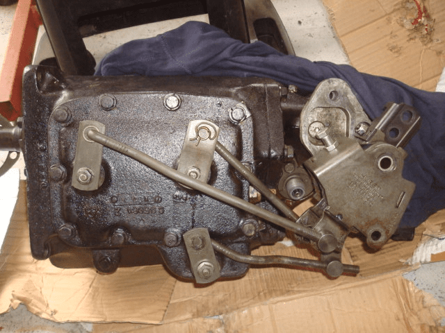

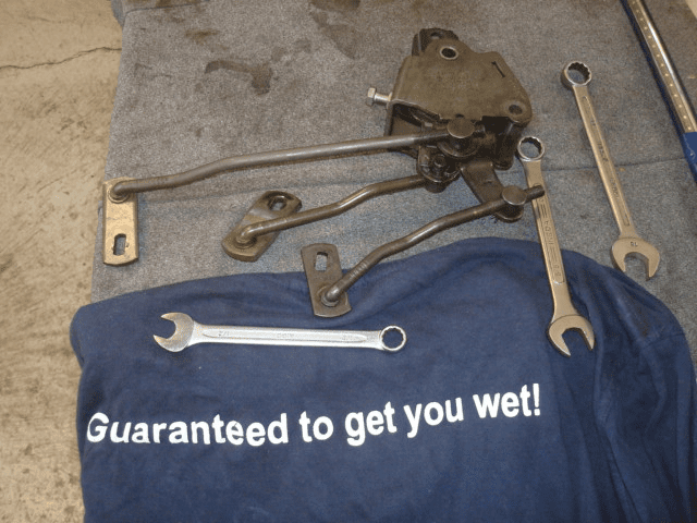

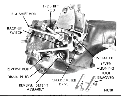

does the bent rod go the other way at the tranny
It goes downwards, the speedometer cable will go above the reverse rod
The trick is to make sure the rod runs free when the gear is selected....rods may have been bent or adjusted over the years.
new reverse rod from Scotty do to new shifter
