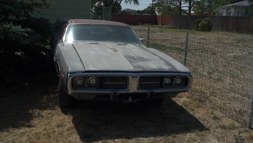

pictures of my 73

pretty clean except the driver side dents.
Looks like one nice project! Good luck with it and hope you'll update us..

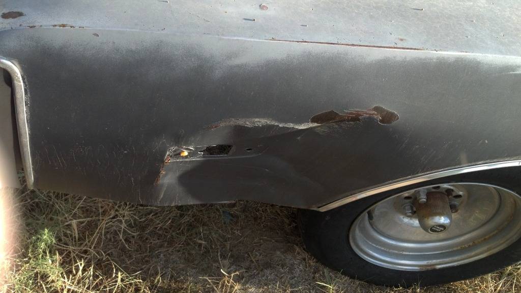

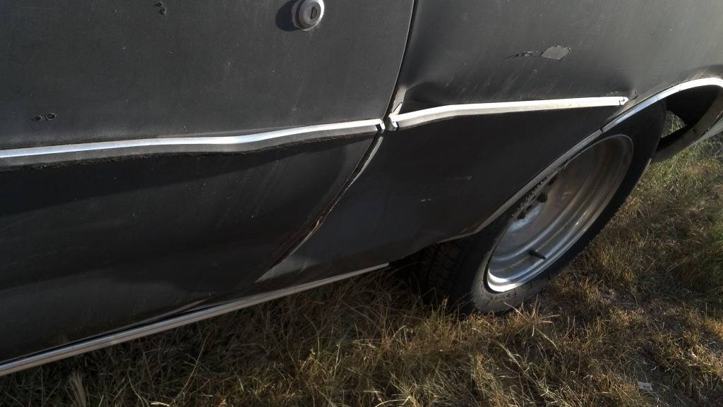

What's the best way to go about fixing the door and rear quarter.
Well there is 2 ways to do that cut and patch the lower quarter panel or go buy a stud welder from Harbor Freight, remove all the paint and weld studs to it then pull it out with a slide hammer. The door might be easier to replace.

there an easy repair ,do you have any basic body repair skills and tools:eusa_think:
have fixed worst and metal finished ,but I have way to many years as a body repairman :grin: today they wack and pack it it just drives me crazy to see some of the jobs :grin:
Believe me or not but i tore a bottom quarter panel out of my sons Camaro once, putty was popping up everywhere in the area, I found a pop can (orange drink) a wad of tin foil and the rest was fixed up, with insulation foam, cut off with straight edge razor, and putty spread and shaped to make it look good.. What got me worse, if possible, was they didn't even trim any rust from the jagged metal around the area, had to be for a quick sell is the only thing i can think of, ive seen worse like newspaper spread over holes smooth sanded and painted with nothing behind it.. some is hard to believe, thats the truth. This Charger looks solid from what i can see, it can be fixed..
