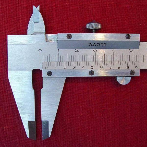

First I've never used this tool. I went online and looked at the pictures supplied with the instructions. The instructions show using a dial caliper. True zero is the top face of the tool. The measured distance is a dimension from the top of the tool to the bottom of the bearing bore. So how did you zero a dial indicator to the top of the tool? I'd try a dial caliper or a depth mic.

I’ll go back and measure with a caliper instead of the dial indicator and see if things change. I know I also could just throw this tool in the bin and start looking at contact patterns, letting them tell me what to do. But I’m a bit obsessive and I want to understand this tool and what it’s telling me.
Good news: measured with a caliper and it all makes sense to my pea-sized brain now. Doug was correct, I wasn’t measuring from a zero’d point. In fact I wasn’t measuring anything at all . How it randomly ended up at the exact number as my shim package will be chalked up as the big guy messing’ with me. Hopefully he got a good chuckle.
So once I measured with the caliper, my measured pinion depth with the .090 shim package is 2.732. Pinion gear calls for 2.721. So I added .011 to my shim package, re-measured: bang. Right on the money. I haven’t added the ring gear yet and looked at patterns, but Ive got to think that starting with the pinion at the right depth is an advantage.

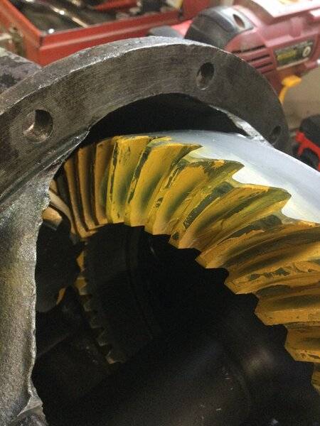

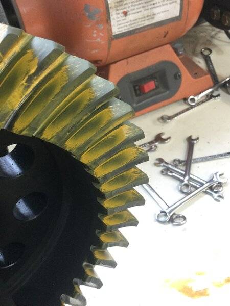

Just as Doug said; when the pinion is at the correct depth, the rest of it comes together pretty easy. I got the backlash to just shy of .008, which I figured was a little less than what I ultimately wanted. Ran a pattern check, and the markings confirmed my suspicion. Pushed the backlash out to .009, and came up with this:
