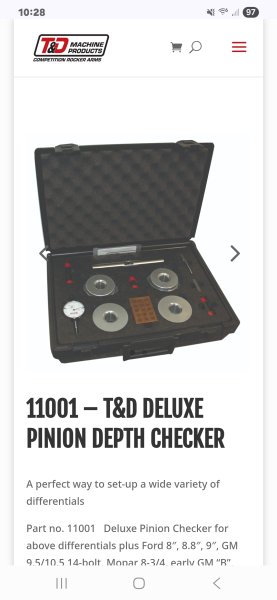

I used to and have done it this way also. I have the T&D pinion depth tool kit now.
