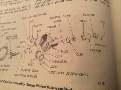

Do you know the number on the housing? It's on the drivers side of housing, the last three numbers is what everyone uses to I.D. the housing. The 489 uses a crush sleeve. The 741 and 742 use shims to set pinion preload. The person who set it up should know. One problem did any shims stick to yoke when you pulled it out? They can be .003 to .010 or thicker. You would be able to tell crush sleeve or not with yoke out. The shims are 3/16" rings that go over the pinion. If you have it apart 1 picture is worth a 1000 words. i'll see if I can find pictures. Google Mopar 8.75 inch rear differential, pictures and click on images.

First pic 741 housing 2nd 742 housing don't have 489 pic. Notice spacer in 741 . 742 pinion is larger no spacer and is the stronger of the two. Duh forgot shims are behind the bearing, geez. Check yokes new vs old??
