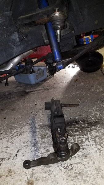

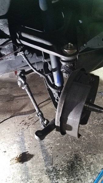

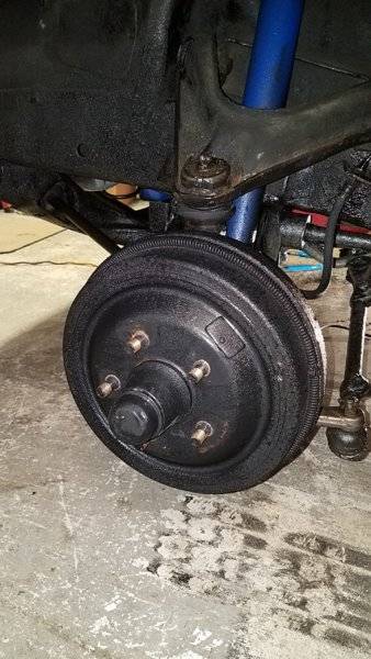

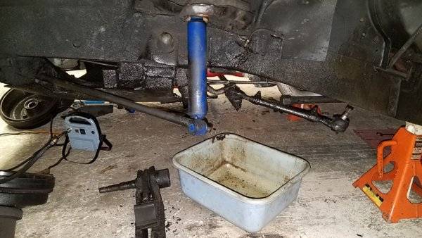

Just got it in for the Disc Brake Conv. Looking to swap out the torsion bars and add stiffener plates on the LC Arms while I'm in there. Ft brake hoses a little past needing to be replaced I can say. Needs a good degreasing!

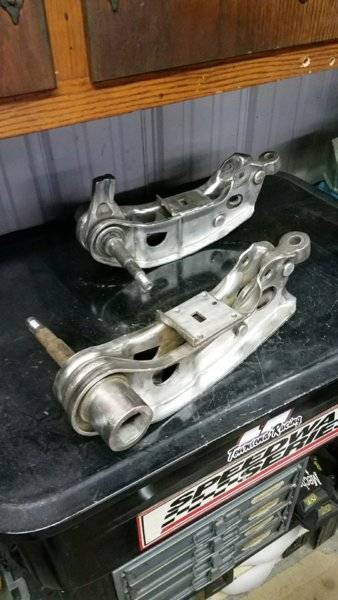

Hot and heavy on it now, but have quite a bit of cleaning to do. Valve covers and pwr st must have been leaking for years! The LC arms are clean, but need new bushings and pivot pins. Mine were NOT straight at all!
