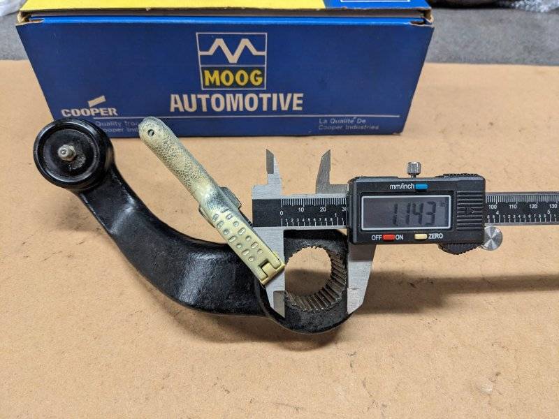

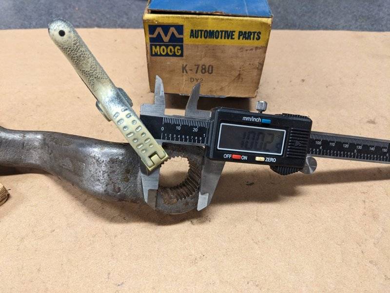

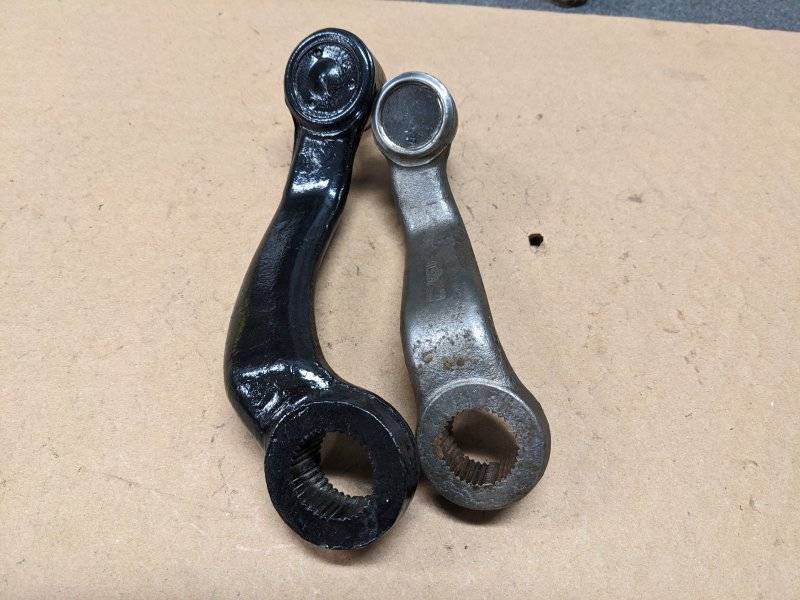

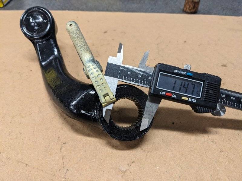

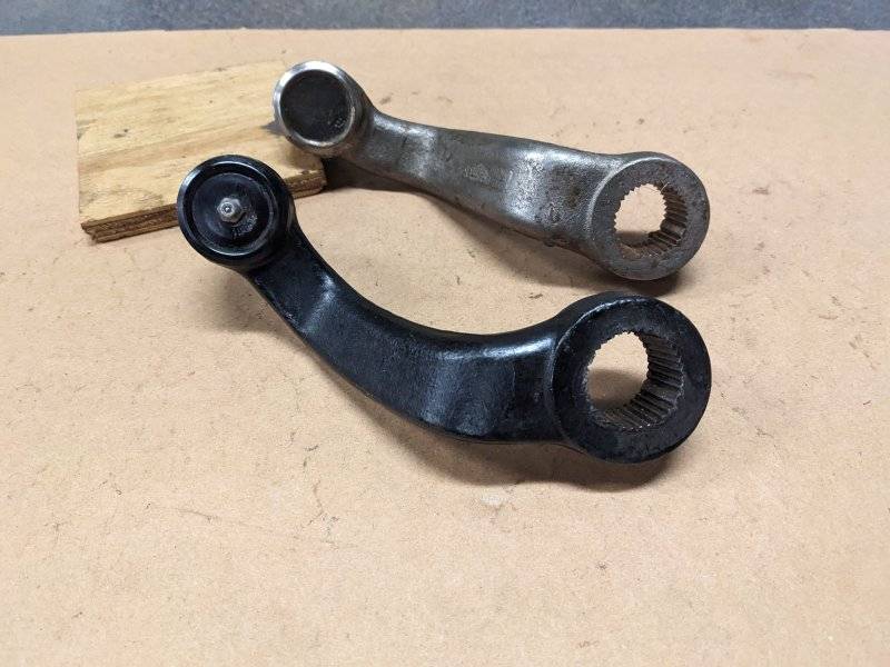

A 1970 Satellite with power steering was originally equipped with a small sector shaft power steering gear, or "box", with matching small sector pitman arm.
Small Sector:
All 1962 - 1972 B-bodies, 1960 - 1972 A-bodies, and 1970 - 1972 E-bodies (except cars equipped with the "TA" box) were originally equipped with the small sector shaft power steering gear. The small sector shaft roughly measures 1-1/8" near the top of the splines on the shaft. The original nut that retains the pitman arm on the shaft has a hex size of 1-1/8".
Large Sector:
All 1973 and later A, B, C, D, E, F, J, M-bodies, all E-bodies with the "TA" box, all C-bodies and D-bodies (Imperial), and all 1971-1993 B-series vans were originally equipped with the large sector shaft power steering gear. The large sector shaft roughly measures 1-1/4" near the top of the splines on the shaft. The original nut that retains the pitman arm on the shaft has a hex size of 1-5/16".
The following image shows a small sector shaft pitman arm for pre-1973 B-bodies (top) and 1973-later B-bodies and more (bottom):
Measuring the actual spline diameter is a little ambiguous, but the following two images show measuring, roughly, the diameter of the opening at the top inner edge of the splines. Note that the measurement is a little smaller than the outer edge of the splines and less than the measurement of the sector shaft splines slightly above where the pitman arm sits. The steering sector shaft is tapered for a wedged fit to the pitman arm itself.
NOS Moog K-780 for pre-1973 B-bodies:
Moog K-7076 for 1973-later B-bodies and more:
NOS Chrysler C-body:
C-body and early B-body compared:

Thank you very much! This is exactly what I was interested in! This indeed will be very helpful for all those that follow in our paths!

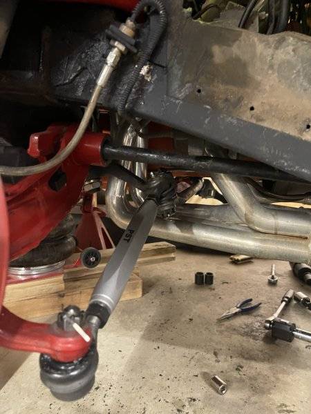

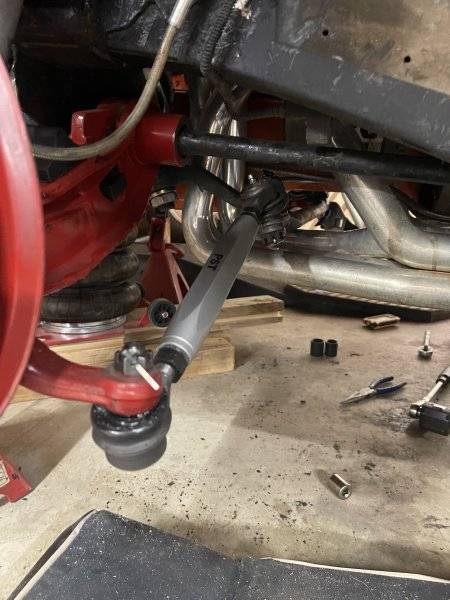

So I have all the steering assembly together and torqued to specification. And there are two issues. Before I start disassembling to isolate the issue I wanted to run it by you guys.
Issues:
1. Steering is tight. With the wheels off and no load the steering is not extremely stiff. I didn’t check this until I had it all together.
2. The steering wheel now turns even without the key. No steering column lock? It was working.
I was planning to disconnect the tie rods to isolate but wanted your opinion before I do anything.
I no longer have any contact between the headers and the center link which is good.
Comments suggestions questions?
