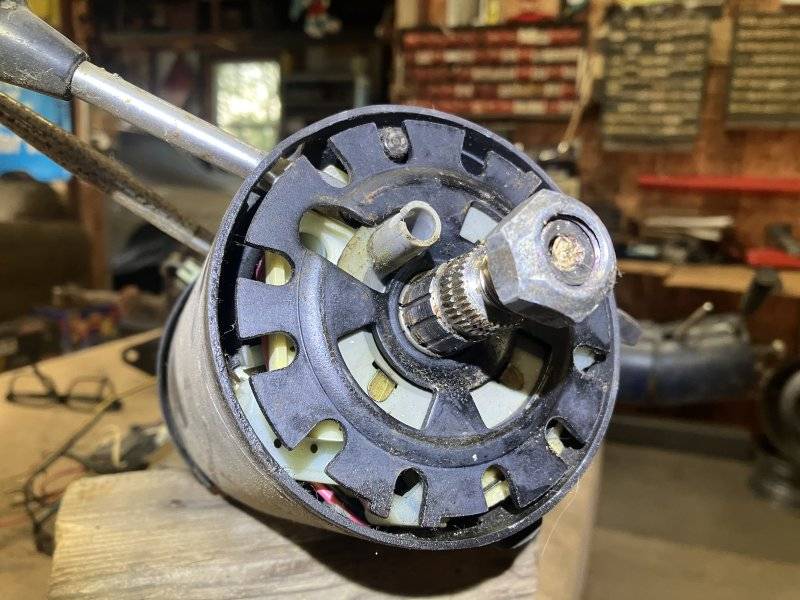

The locking steering is not related to the linkage underneath. It is inside the column right near the ignition lock cylinder like so:
That black plate is cogged, in this picture there is a pin near 12:00 that engages in a recess in the plate to lock the steering. If the steering shaft is somehow shoved away from the engine and toward the driver, that black plate moves with it and the locking pin won't engage the slots in the plate.
