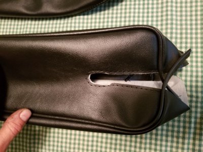

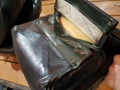

So this is what I have learned in case others are dealing with this. The seat I got from Stanton was out of a 68 Charger, which we knew before he sent it. You can see on the back it is just overlapped and held in place with 2 screws. This is how all 68's were made. In 69 they went to having a slit in the cover and hiding it with the plastic trim peice. This system was used on all buddy's made 69 and later. And the second pic is of what Legendary sent me which is correct for a 69 like 69 GTX posted above. So with the trim peice from Tim, new covers to match my 69 pattern, and a 68 core seat, I should be set for my Bee.
