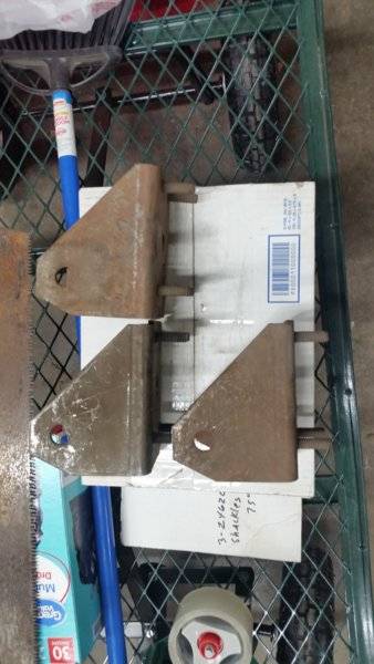

please help identify these spring hangers
rbkt65
5:53 PM
Mar 19, 2011
531
303
jerseyville,illinois
someone says b body dodge. someone else says b body plymouth. part number on 1 hanger is
2462086. if more photos or measurements needed i can get tomorrow. thanks in advance.
2462086. if more photos or measurements needed i can get tomorrow. thanks in advance.View attachment 847874
Dodge Plymouth same thing. Not any on what they fit, bolt hole measurements would help. They vary from 62 to 66 and maybe later .
We have a 65 Dodge Polara here, I could measure for you. I'm not sure on 66-67 Ply or Dodge
what there spring bracket is.. but I'm pretty sure that 68-70 Plymouth is different than Dodge, hence the difference in length of wheelbases. The brackets in the pic, look like Plymouth to me.. but that is my own personal opinion. Dodge33

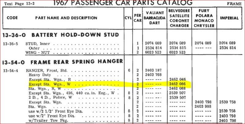

thanks, the 68 parts book says 2462086 for dodge and 2539507 for plymouth. i will try to get some more measurements. thanks again.
What's the wheelbase of 67 Charger versus a 67 GTX? if the same, one part number....
Where is the 1" difference? floorpan??
Shows that the Satellite is a different part number in the book (above).
R = Satellite, W = Coronet/Charger
Aha! So, there's the wheelbase difference, in the front spring perch!
here is a picture with numbers on my hanger. thanks for all help so far.
Here's a 69 DODGE B Body spring perch.
Look at the difference compared to Plymouth perches in first post.
Difference is because of longer wheelbase of Dodge versus Plymouth.
