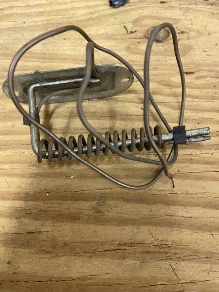

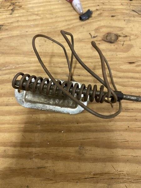

Please help identify this critter
roadrunner57
12:42 AM
Feb 26, 2020
1,722
934
Virginia
Thanks in advance.
That connects to the heater control valve via the capillary tube . And that part mounts to the bottom of the a/c box. Yours is apparently broken.
