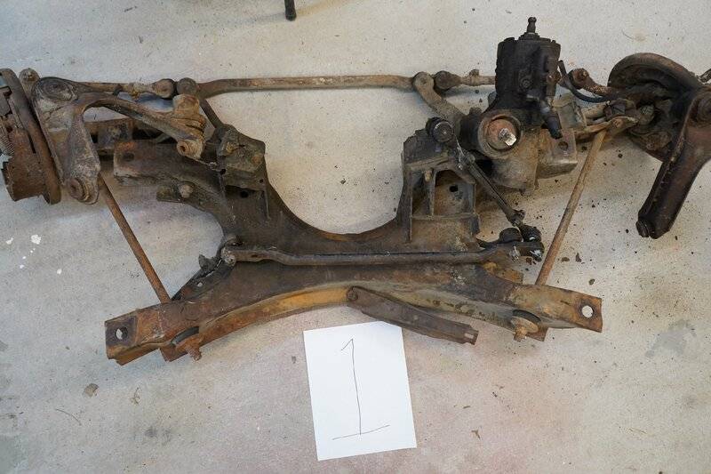

Please tell me the years of these 3 K frames

I found these near me!
All 70-72 B or 70-74 E. Cannot tell from the pics if any are 70 B vs 71-72 or E-body. 70's have a slightly different angle on the steering gear mount.

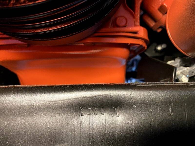

Here is an example. Mine is 2330 which is Aug 21, 1970. 233 day of 70.

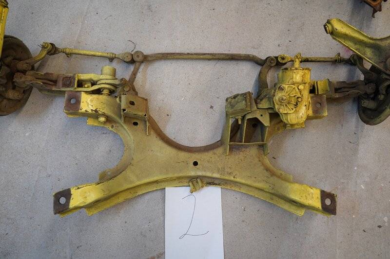

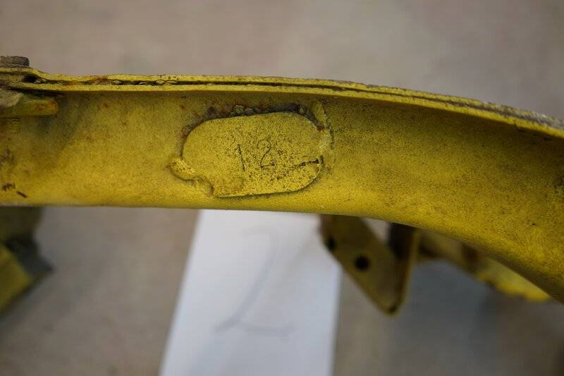

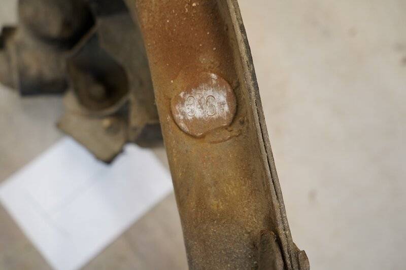

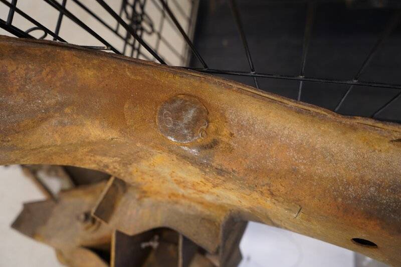

I do not see the stamping like on yours T2R9 but a large welded tag, 06 on #1, 12 on #2 and a 6 or 9 on #3

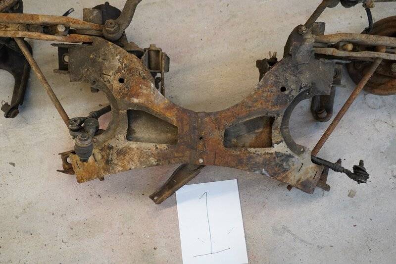

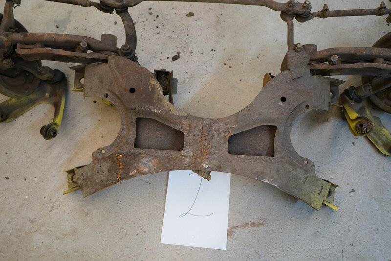

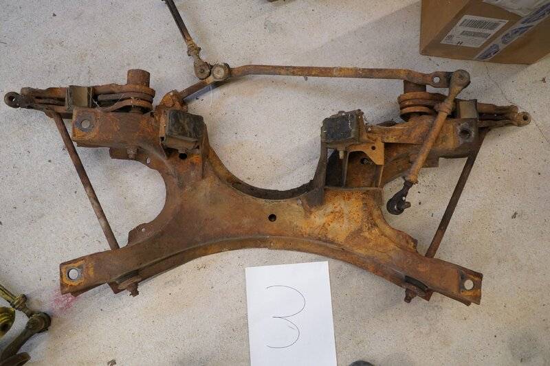

Here they are in same number order, #1, #2 and #3, what do they mean, is there a decoder ring for this?
12 is a E-body. That 06 is more likely a 90 which is a 70 B-body. Can't find any part number ending in 06. Last one could be a 90 but stamped on a Friday after lunch?
That 06 could just as easily be the 90 referenced above.
With some work I cleaned off the code and can read them very well. I put a comma after the four digits just to make a space for the last fifth #.
#1= 1680, 2
#2= 0200, 2
#3= 3089, 1
I need a 1970 (one year only K-frame), so is #1 the winner for my B-Body?
#1 - 168th day of 1970 which would be June 17, 1970 (Wed), made on the second shift. Very late model 1970 B-body.
#2 - 20th day of 1970 which would be January 20, 1970 (Tue), made on the second shift. Mid-year 1970 E-body
#3 - 308th day of 1969 which would be November 4, 1969 (Tue), made on the first shift. Early model 1970 B-body
So one and three are the winners. They don't have the 70 specific sway bar pieces either if you wanted to run one.
