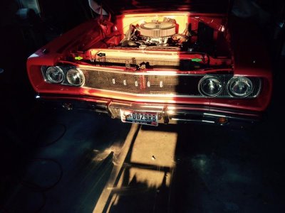

Rob,
All I can say is that your headlight harness is the most bang for the buck that I've spent on my 68. The harness fit right behind the original across the radiator support. After installation I drove around the sub at midnight. But didn't stop there, for the low/high beams I got some Hella H4 Single High/Low Beam Headlamp w/halogen 60/55, and for the high beams just some basic sylvania sealed beam Halogens. The combination is perfect, low beam driving is sweet and the high beams are spot on.
Since I live 20 miles out of town having adequate lighting is a must. I have a 500 hp 451, and now I have a 500 hp lighting system to match. This upgrade is a must. And here is the deal--the harness is plug and play so if you want to roll back the upgrade to sell your 'original numbers matching' beauty just unplug it and throw in the old headlights. Done. :headbang:
Green arrows are the additional groundwires. I located the relay block passenger-side just behind the headlamps on the inner fender, so there is just a short run to the alternator. The black wire is the harness going back to the driver-side beams. See Props write-up for info and the best place to buy the Hella's : http://www.forbbodiesonly.com/mopar...Headlight-Conversion-1969-Plymouth-Roadrunner
