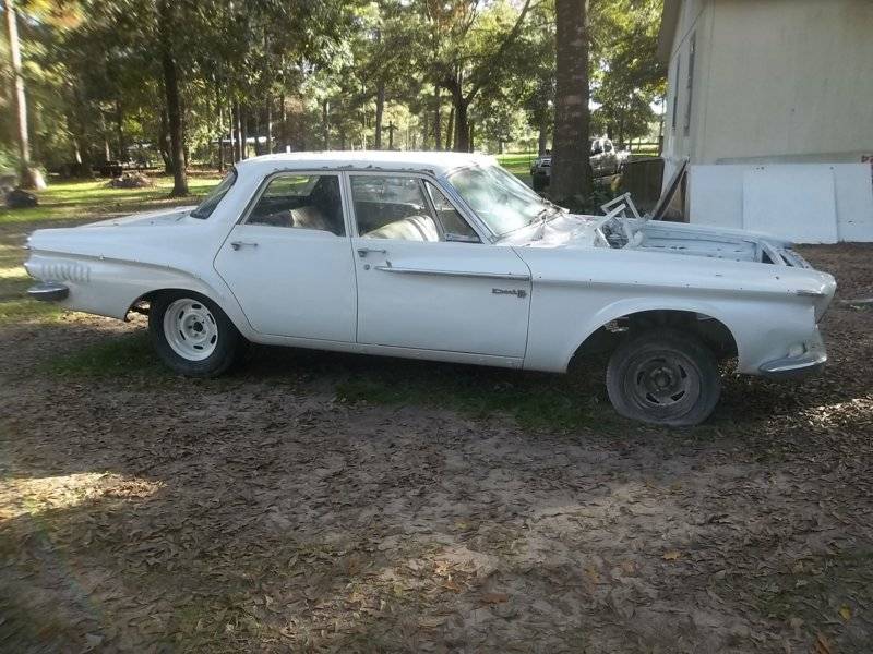

Here is my 62 Dart 330 I just finished my body/paint work on. Not perfect but neither am I! Key words: No rust, has scars of life, 5-10 footer!! lol

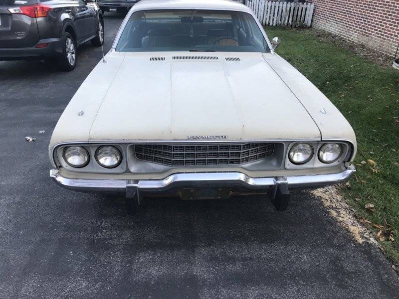

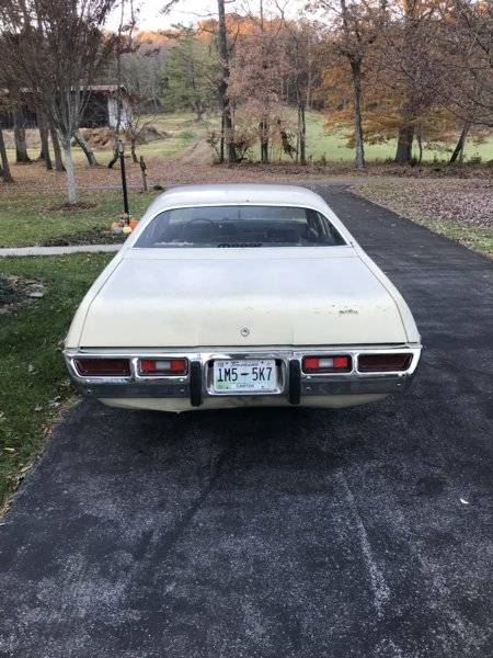

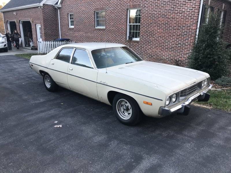

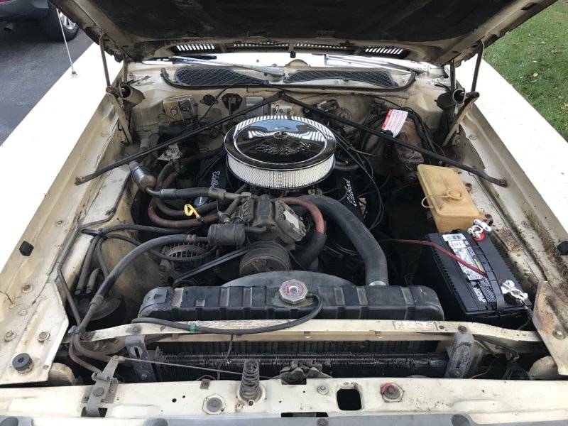

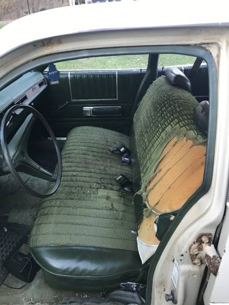

Hey guys, I ended up buying the car. It’s pretty cherry. 49k original miles with the 318. Starts on a half revolution of the starter. Strong runner. The seats are shot, but everything else is perfect.
