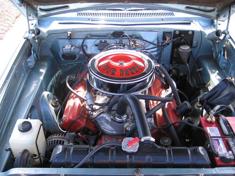

I have the factory 4bbl on my 64 Fury Convertible. Hotter cam from Gary Pavlovik (Mopar Mailing List) and it runs great. New 4bbl carb from Edelbrock to top it off. Starts first time, every time and has great pickup and nice lope...

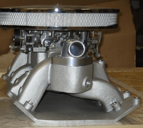

The Chrysler Power intake fits fine under a stock hood - it looks taller due to the open runner design. Compare the height in the pics below of a Weiand 7503, the factory 4 barrel, and the Chrysler Power manifold. It's not much taller. The info I gave you on the manifolds is legit. I started with a 7503, and swapped to a factory 4 barrel. The advice on the Chrysler Power was straight from Gary Pavlovich himself (poly guru and part designer of the manifold). He supplied me with all my parts including a hot cam, but told me I'd need to go bigger again for the manifold to work properly.

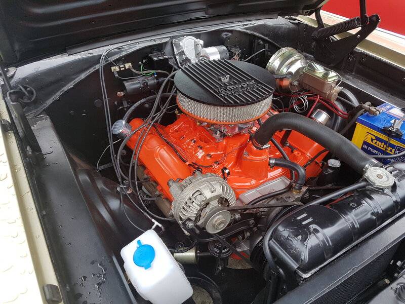

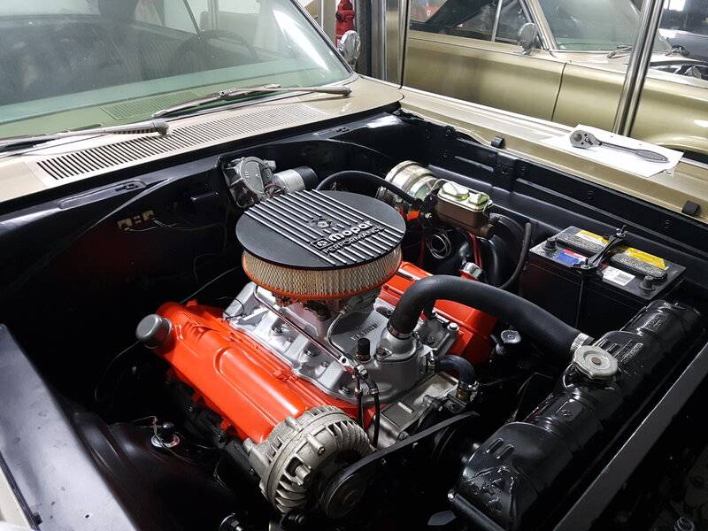

The Chrysler Power intake fits under the hood of the early "B's" ok as in the photo below.
A friend of mine has the CP Intake on his built Poly stroker. It fits under his stock 65 Coronet hood just fine. Bill (my friend) actually penned an article on his motor that appeared in CP Magazine. Interestingly, at the time they did a comparison to the Weiand single plane intake on the dyno at JBRE in Glen Rock PA. The CP intake was better everywhere, all the way to 6000 rpm. Likely due to the raised-runner design. It's not cheap, but well worth it for a hot combination.

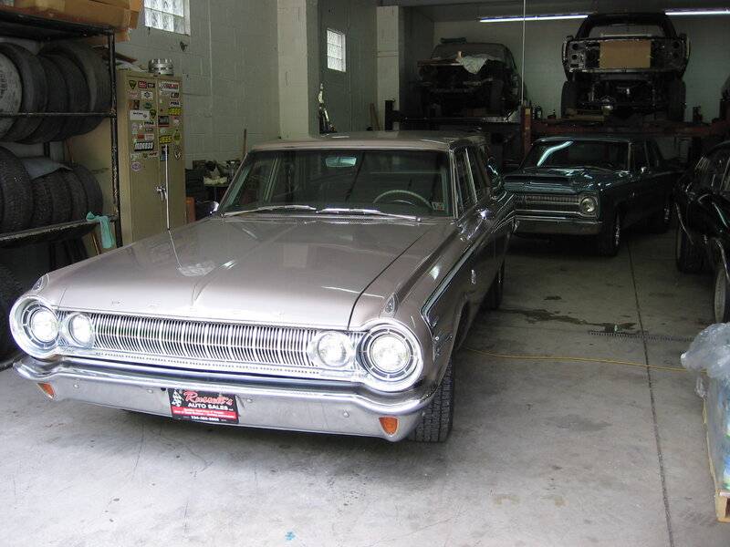

OrthmannJ, Just so you know TTI exhaust makes a full dual exhaust for the 64 Wagon. The 64 Dodge wagon pictured above has their exhaust system on it. It has their headers but they do make it from the manifolds.
