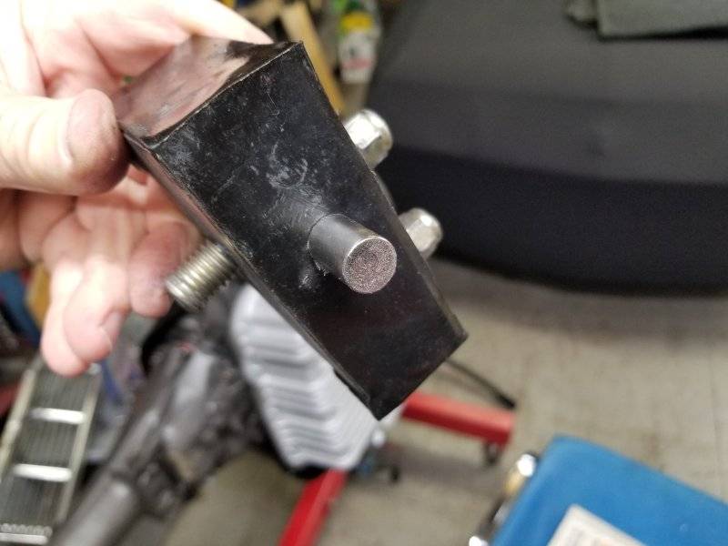

What are your thoughts on these ? They were in my Belvedere when I bought it. It has been a race car for quite a while.

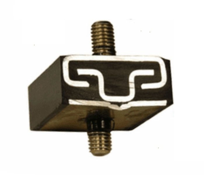

A magnet sticks to the middle of them. Im thinking they're PST Polyloc ?
Or Schumacher's as they have poly lock style too.
Having a magnet stick to the middle would tell me there's steel inside the poly.....right ?
Schumacher's mounts are terrible, major design flaw.
Can resist pulling apart, somewhat, however engines do not pull at a 90 degree angle to the mount, engines twist, mounts slide apart.
It is difficult to tell and/or see when they fail, but they fail quickly.
I've posted about this before.
Whatever mounts you use, drill a hole and run a bolt/nut through the center.
I agree with matthon in that polylocs are not the best mount. I had one fail myself....
