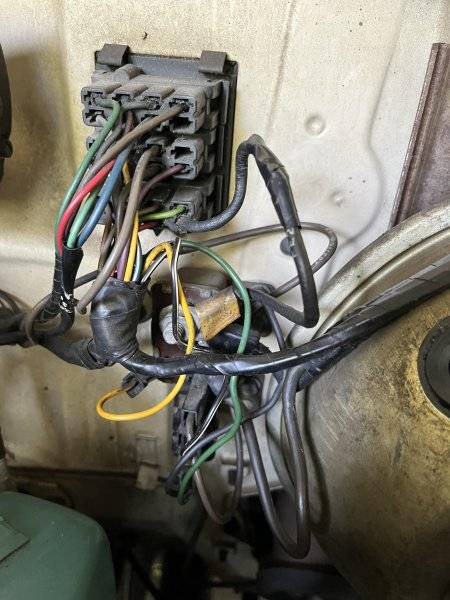

Wire with yellow tag that says fusable link is bare and swollen must have over heated,
i put tape on it
It looks like you have some visible corrosion where the connectors pins crimp on to the wires. After all, these connections are 50 years old. Have you opened up the bulkhead connector to see what condition the pins are in ? If you have a FSM look at the schematics and identify which wires are related to ignition and inspect further. Might want to think about replacing some or all the pins.
