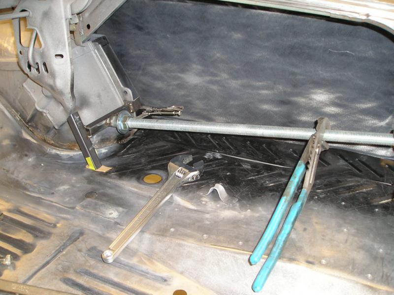

So like any in any full tilt boogie restoration, you're bound to find some things that indicate whether you have a "Monday built" car or a "Wednesday built" car on your hands. I think this convertible was a "Monday, 4 a.m., before the Schlitz wore off" built car. My first clue was the original trunk pan was welded 1/4" too high on one side giving me fits with the replacement drop offs. Ok, no big deal - cut it loose, weld it in where it's supposed to be and fill in the holes in the wheelwells.
Next up, I fit the trunk lid and find it's sticking out from the quarter extension by 5/16". :eek: WTF ?
It's then I realize this corner of the car is pushed in somewhat. There's no visible damage (dents or otherwise) so I don't know if it was tweaked from the git go or suffered from a telephone pole-ectomy, but this was my ultra-low budget solution to reintroduce this car to geometry.
Works like a charm. :eusa_shifty:

When there's a will there's a way, and you proved it, way to go.

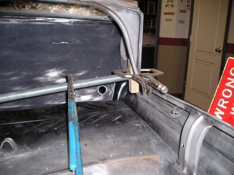

View attachment 108203View attachment 108204

Used one of those small floor jacks to do a similar job once. Nothing like home grown engineering!
Good thinking outta the box. I've had to use a ratchet-type cargo bar to push some metal out.
