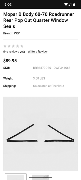

Can the rubber seal on a pop out window be replaced without taking the frame work apart? These windows fit terrible, no matter what I do to try and seal them. Maybe the orginal seals have shrunken. What a poor design. My car has orginal 1/4's.

Are these the original windows that were removed from the car ?.... Detroit muscle technologies has them
I know that DMT has the V looking seal. My question is, do I have to take the pop out frame apart to replace it?
Yes, they are the original windows and rubber, to the best of my knowledge. They look to have been out before for painting. The gaps below the drip rail, top of window seal and bottom seal of window to the 1/4 panel are terrible. That's what caught my eye and the reason I got into this can of worms. Do not want to use regular hardware store foam to fill gaps, it holds or wicks water. Too large of a gap to use black rope caulk seal.
I just went back into DMT's website, seems that I always have trouble finding stuff in that site for some reason. Didn't know that they offer a whole kit, not just the rubber seal. Also didn't know that Dodge and Plymouth were different.
