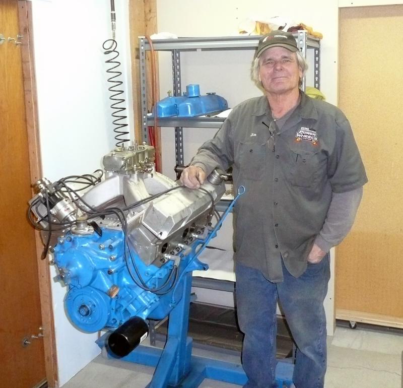

Pop's 440 is near ready to dyno.

Jim with Pop's 440 - March 21, 2014

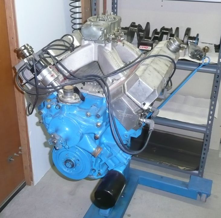

140 PSI cylinder pressure, XE285HL cam, 548 TQ and then @ 6,000 RPM, 585 HP.
Wow, impressive enough that you achieved those numbers, so much more impressive that you did it at reasonable rpm levels.
More details please...
Hydraulic lifters?
Preload?
Spring pressures?
Pushrods?
Pretty please...
Achtung!
I went back with the solid lifters, .005" hot lash.
140# on the seat and 360# @ .600" lift.
Smith Bros. 3/8 X .080" wall
We have two dyno sheets that say 595 HP @ 6500 RPM where we shut it off. With the big heads the little cam just never quits making horsepower. 500+ TQ from 3500-6000 RPM. Imagine 508 lb-ft @ 3500 rpm with 2.25/1.81 valves and full Max Wedge ports.
