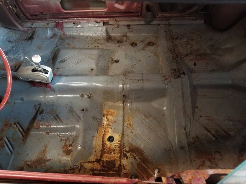

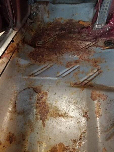

Just ordered a Por15 kit to do the floors in 65 Coronet. My floors are very solid just wanted to preserve them . Does the Por15 work well and stop any rust. I have some light surface rust no holes. Also I'm not doing a rotisserie on the car just a real nice driver hopefully. What do you use on the frame and inner fenders and quarters, trunk once cleaned up same thing

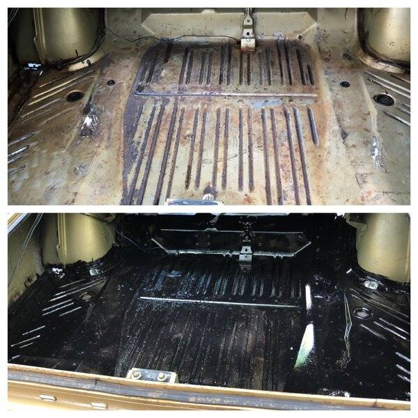

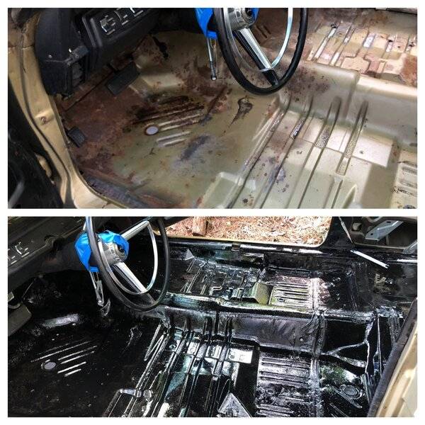

I wouldn't guarantee there is nothing better but I used it on 3 restifications in the past 20 years and have not had any rust issues resurface. I did however use their directions to the tee. I know it gets hard to remove once dried. I also used the POR 15 in a tube for a few pin holes in the floor of my 60 Dart 20 years ago and the area has not pealed, blistered or chipped yet. IMO, if you don't want to use it as directed you probably won't be happy with the results. That don't only apply to paint.
I am good with it. I used all 3 applications as directed and it came out great. Respirator. You will not make it.
