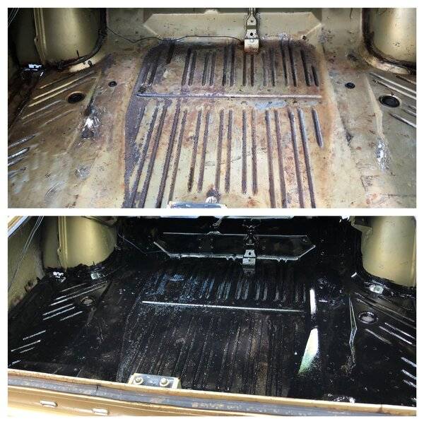

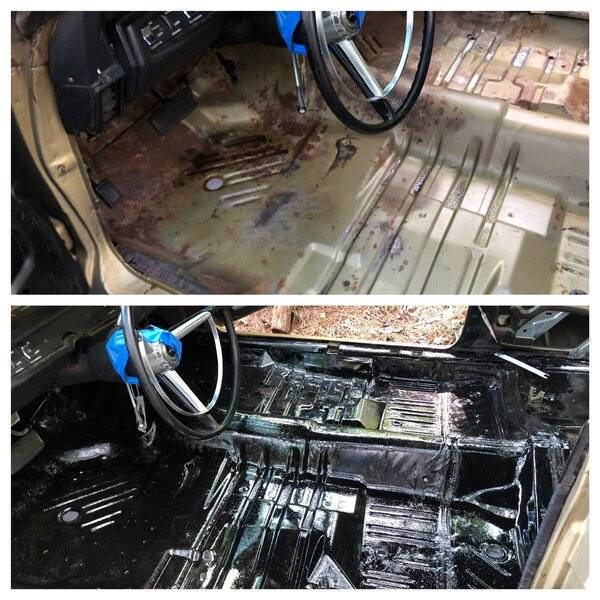

I painted the whole floor pan, trunk pan, and underside of my charger in it. Love the stuff. I thought I was going to have to replace everything but it brought it back. It accepts paint and undercoating really well.

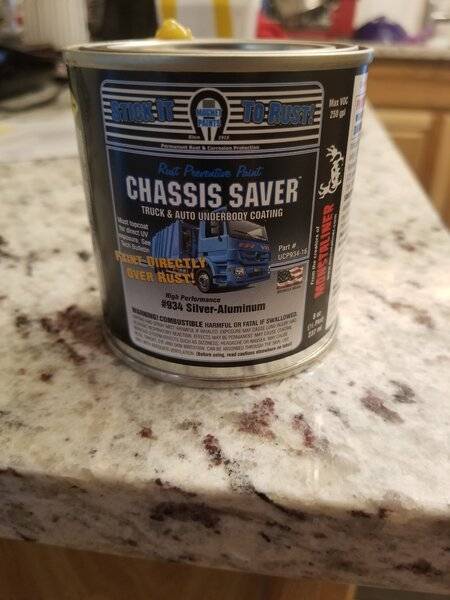

My choice is Rust Bullet. It is idiot proof and is stuck like glue to frame rails and trunk area. Clean, unclean, brushed, not brushed...it is on there good.

Agree with threewood. The silver Rust Bullet is by far a better product than POR.
