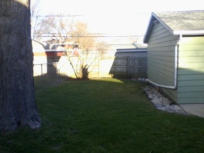

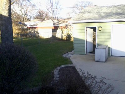

it's not so much the cost or anything-I would love another permanent structure; it's the possibility of me having to take the damn thing down cuz one of the neighbors opens their big yap to the city--i dont think they will, but you always have to guard against the downside.
See, I dont have much space in my little slice of Republican heaven here in Lombard, ILL :unitedstates: (balanced budget 5 years in a row now WITH a healthy surplus which they save for unforeseen circumstances), and they don't allow you to have more than 50% of your land "building." maximum is 50% green, 50% buildings.
****, I would have doubled the size of my garage a long-*** time ago if I didn't have that restriction!! lol
soooooooo it has to be the best semi-permanent I can make it.
pics...(the pavers will be removed of course)
****! build it here! on the other side of town, the yard is 280' deep

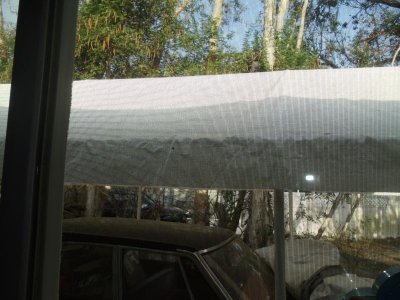

I get two years out of the tarp part(FLA). Check out the tube wall thickness of tent you buy. Before you assemble it spray the inside of the tube ends with rustoliem professional. Also add four cables on the end sections to stiffen the frame(triangulate the ends to middle poles). I used coated cloths line wire. My frame is 6 years old now looks like new. I purchased two gallons of the rubberized roof paint, but put it on the campers. Think that would add a lot of life to the tarp... Also added large zip ties loose over the bungy ties supplied. the zips have come into play when the winds got over 40( I put two 3" tapcons on each base). 10'x20' Eight Post from shelter logic. look for discount codes online.DSC00045.jpg

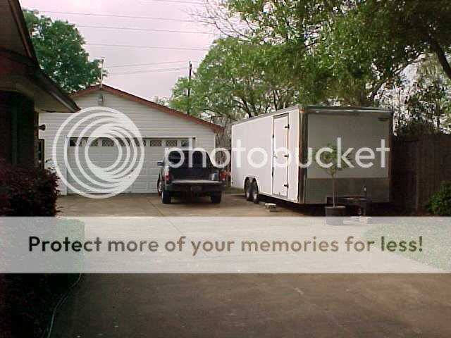

Got a use for an enclosed trailer? I know they are not exactly cheap but if you can find a decent one for a good price, you can usually get your money back when it's time to sell. I got a killer deal on a Forest River 24 footer a couple of years ago after moving out of my storage building. The money I was paying for storage paid for the trailer and the best part about it is I can move it whenever I need to and there's no taxes paid so long as I leave the wheels on it. So far no one has said anything about it and if they do, I'll just move it behind my shop. As it is, it's off to the side and up front but it's still 120' away from the road. Unless you are looking, it not real noticeable since it's the same color as the shop is. I keep a car inside along with several parts and lawn equipment. Here's a shot of mine taken from about 1/2 up the drive.....
And yeah, that little tree hides it pretty well....wish someone would come and get it.
The big used {especially IF you can get it cheap} enclosed car hauler
is a great idea too, kill 2 bird with one stone, storage & something to tow/haul in too...

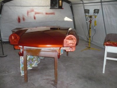

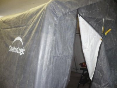

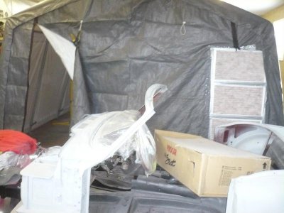

The only sure way to use a portable garage and not have to worry about weather, wind etc. causing collapses and damage to a vehicle is my way!!!
Here is my portable garage...or should I say Paint Booth???:headbang:
Rocky
I like this idea for a paint booth but man, I hope you guys don't blow up your beautiful mopars (and yourself) by igniting paint vapours. it's pretty risky using lights, particularly hot halogens and various fans and blowers in these spaces.
