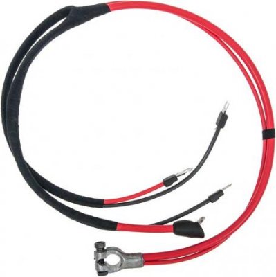

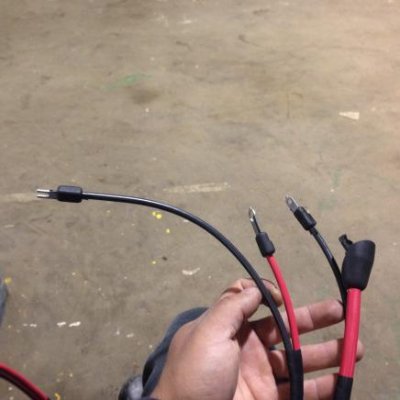

Where do the 2 black wires and red wire go on the positive battery cable? The big red wire is obviously the starter feed. Does the black one with it go to the other starter post. My wiring diagram doesnt show the other black and red wire. Thanks

I can't tell is the right side of the photo, is that a ring terminal or battery clamp?
Yes the far one on the right is the main battery cable. It is wrapped together with a black wire. The other 2 wires are a black and red wire wrapped together. The black wire has a fork terminal on it the red a ring fitting. Any help would be appreciated. Thanks
Still a bit confused. Does the black wire that is wrapped with the main 0 gauge wire from the battery go to the starter solenoid?
Where do the other black and red wire that are taped together go? The car is a manual transmission if that makes a difference. Thank you
Just a guess. Need to use a multi-meter, and see if the two black wires are connected, which would make sense. If they are the same...past the positive battery connect, the red and black leads that feed to the starter, red to the main lug. Black wire to the solenoid. The other (forked terminal) end of the black wire to the square center terminal on the starter relay. The red ring terminal should go to the main (feed) lug on the relay, that supplies power into the car.
At least from the different diagrams I've been looking at, that's how it's wired up. Where did you get that cable from? Looks like one I could use on my mess.
If I'm wrong on the power feed to the dash, feel free to straighten my act up. Still wiring mine up, and getting my head around that one thing, since you would think power would be 'on' all the time to the dash. But, that's the way it shows.
Just be SURE those two black wires are the same.
