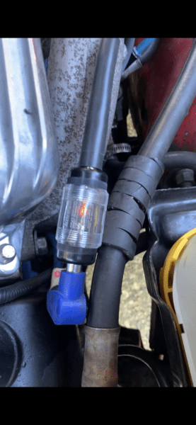

Looks like I have a weak spark, It’s orange color, see photo
Any ideas? Thinking of just upgrading to msd ignition system.

983601F5-A217-4EAC-BDEB-5CE0D8000374.jpeg 017E4A00-62AB-444C-B90C-DF418BECEDC1.png
