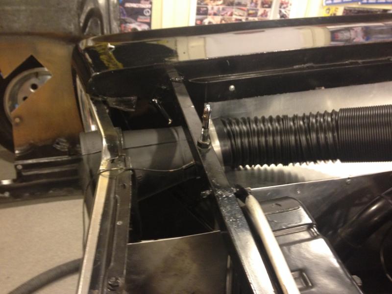

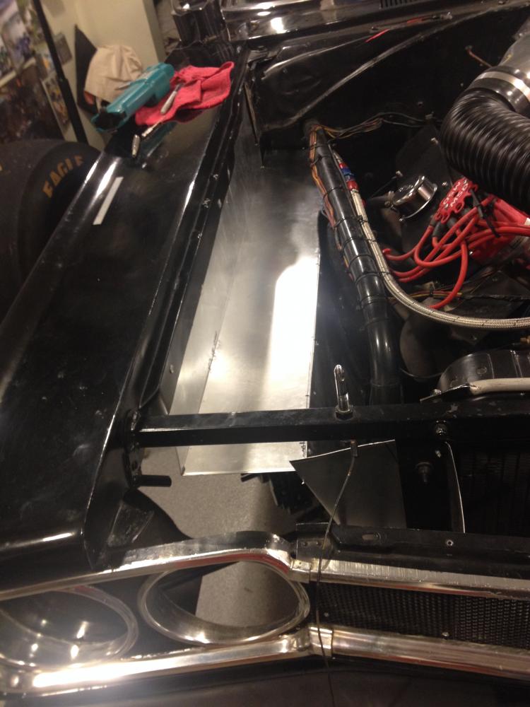

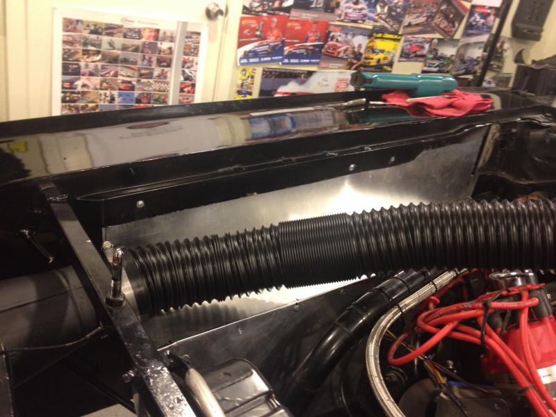

I had thought that it was a big tire when I got the car but, there still fairly new I wonder if there is a calculator to really nail this down to the proper size. I beleive it s you also talking about areo for this car also. I have been working on that but had a mishap today. I had my cordless drill on top of my radiator and knocked it off and it punched a hole in my radiator. That hurt big time. I have a few pics to show on how I built my al wheel well covers. I think that is going to make a big difference since there was way to much in the open. around the engine. 2014-12-28 16.24.51.jpg2014-12-28 16.26.06.jpg2014-12-28 16.26.17.jpg

those inner fenders should help to keep some or most of the parachuting effect out from under the front end
I am hoping that it does I found several areas that are catching air. Trying to get them covered. I am actually fabricating a part for under the front bumper to push the air gently downward and under the car.

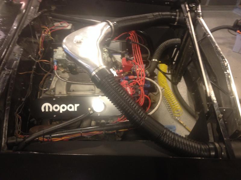

2015-01-05 16.04.18.jpgJust about ready for my first race on 2015. The only thing I need is my radiator fixed. I dropped my cordles drill between the engine and the radaitor and it punched a small hole in it. In the shop now. thought I would share this pic I took today

I hope to say goodbye to the 11 second times. Prior time best for me 11.06 to date. I removed 132 lbs and elimiated several air dams in the engine compartment and wheel wells.
