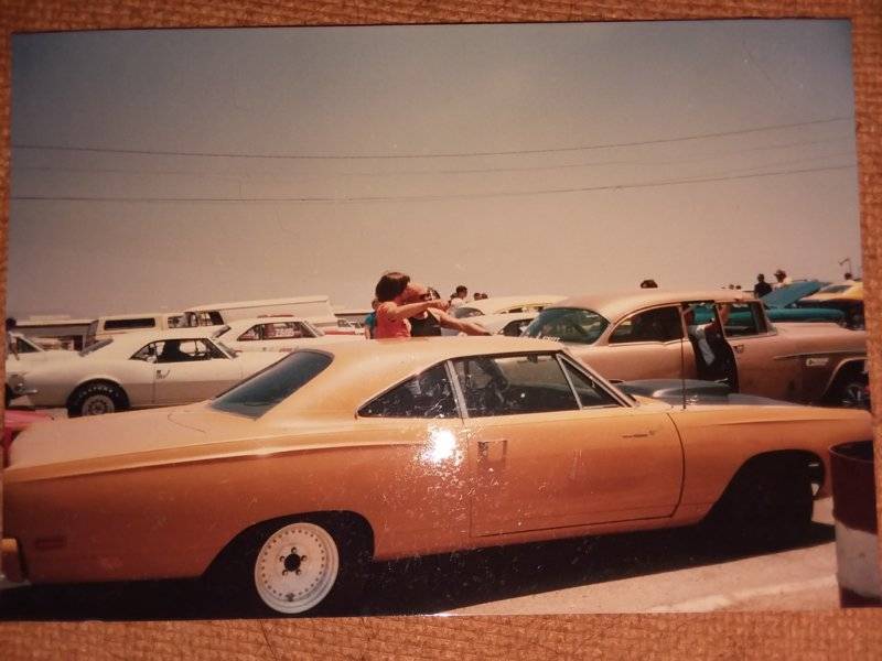

Stone bone stock A12 runner. It sat for years, not running.A friend bought it,found one of the sets of points grounded. I bought it from him with the intake,carbs, and aircleaner in the trunk.
I got it running with a known good 600 Holley and a tm7, not exactly the best-matched combo, while I rebuilt the sixpack setup. Ran with the 600 at riverside, 14.40s
With the six bbl, 13.60s. Pic is from Riverside raceway,late eighties, turn nine , the staging lanes for the one mile long backstretch dragstrip.
They used to run four wide 1/2 mile drags there in the fifties.

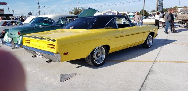

13.6 sounds "about right" given the circumstances.
I've arrived at a point where I haven't been to the track in a year, because I bent the crap out of a Mancini top of the line (of the 2 they offer) pinion snubber, and I've been fighting wheelspin and crappy 60ft times.
I have a complete new front suspension system going in along with 4 wheel Wilwood disc brakes, and then asap I'm going to get Calvert split mono leaf springs and Assassin traction bars, Calvert sliders, and likely double adjustable Viking rear shocks (I currently have Viking double adjustable shocks on the front). I also have a Hydramax hydraulic throwout bearing and plan on getting the HitMaster launch control system, and getting both of those installed, hopefully my street strip clutch disc and pressure plate are up to the task of slipping some on a powered launch. I'm also getting my line lock installed, so at some point in that process I'll be hitting the track again, expecting 12s once I get my 60ft times better.
It's a real V-code 70 Roadrunner

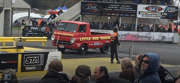

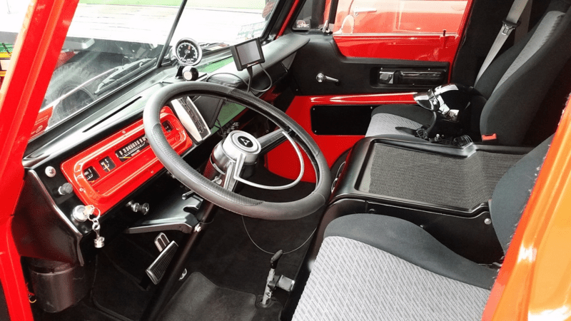

BluePrint Engines 408ci Stroker with Holley Sniper EFI. Automatic transmission with original 3-on-the-dash, Nitto drag radials and Vintiques all round. Gear ratio was 4.10:1, and a 8-3/4" Sure Grip unit. Well prepped track...ready for some really fast cars that day.
Wasn't able to run after this one - broke my belt and punctured the radiator that day. Great experience though. :)
