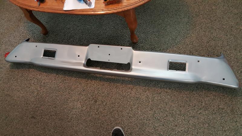

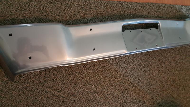

Just thought id share, I'm working on a 67 Dart for my wife and since chrome is getting way expensive, few calls people wanting $425 per bumper looked into what's called extreme chrome powder coat, got both bumpers, vent window front frame piece and rocker panel covers all done in this for $120. Here are the bumpers
These require a clear coat which gives you this look but if you choose to not clear coat they shine just like chrome. It's crazy, plus last longer then chrome will.

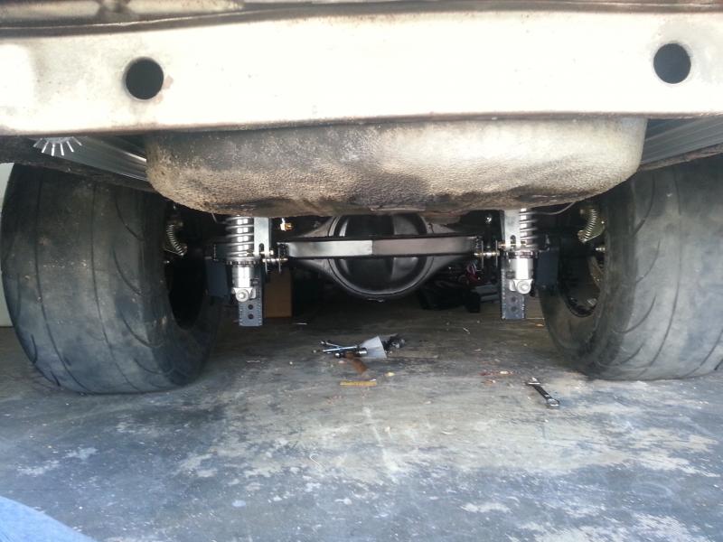

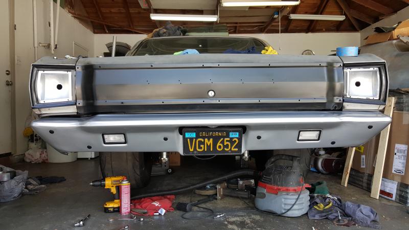

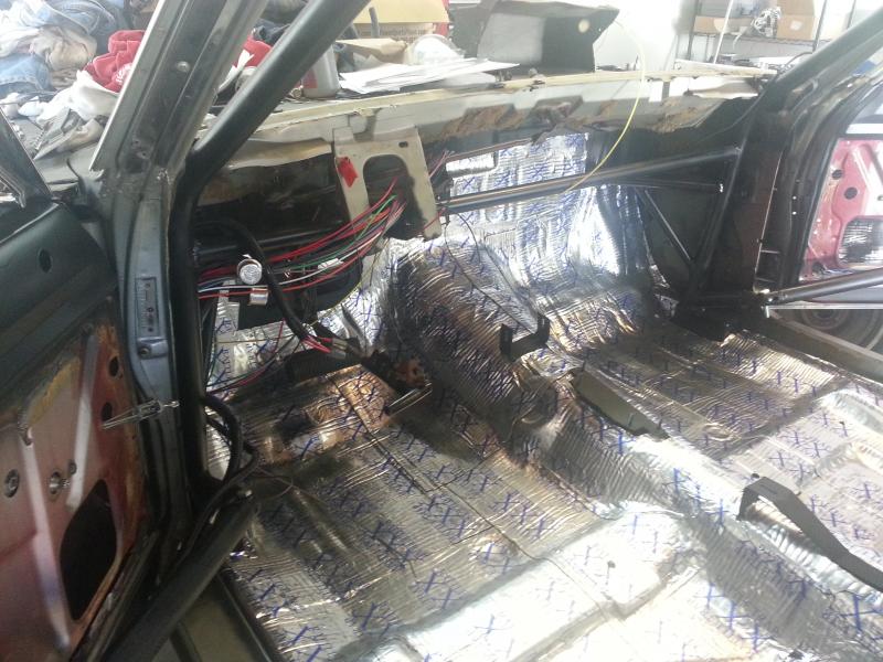

Here are a few more of the car. The wheels are at the highest setting, can drop it down to where the rim in just inside the well. The car has a 12 pt cage, coil overs all four corners, tubular control arms,triangular 4 link, mini tub, 9" 3.50 gears with spool. Fuel injection twin turbo set up.

... These require a clear coat which gives you this look but if you choose to not clear coat they shine just like chrome. It's crazy, plus last longer then chrome will.
If you DON'T clear coat chrome, silver, gold (and even some red) powders, they will all eventually oxidize. It's because there's metal in the powder. These colors are not UV stable on their own -- thus the clear coat -- and without it you'll be polishing that powder coat forever after a few months.
