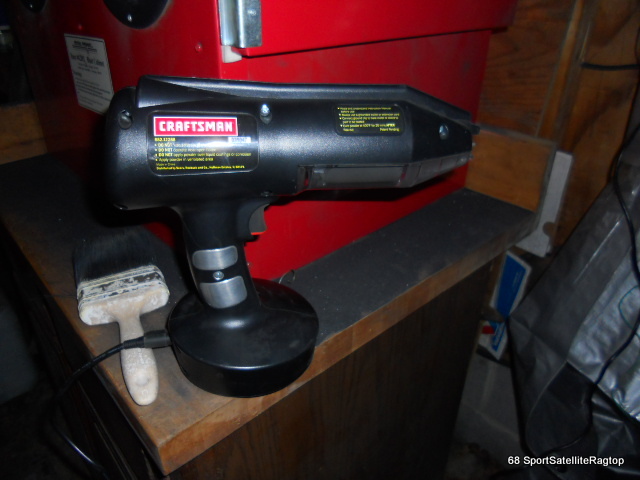

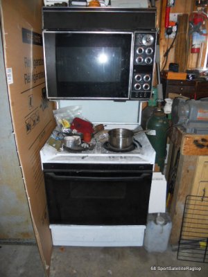

I have powdercoated all the pieces for my suspension that would fit in my 30" oven. The pieces on my Belvedere have been done about 4 years now and are holding up fine. They have been exposed to brake fluid without any peeling issue. The finish holds up to tools where as paint will typically pop off the corner of fastners. I set up my own oven, free off Craigslist and bought a Sears powdercoat gun off E-Bay for about $50. Powder is fairly cheap. Somebody posted a while ago about the finish not holding up to UV, but for suspension pieces, I don't see any problem. The parts need to be clean, as in glass/sand beaded to accept powdercoat.

I am sure you are aware that once you cook parts in an oven the oven is no longer suitable for cooking food! I got an oven for free off Craiglist,turns out it was an oven with a separate small oven built above it, great for small parts. I don't know for sure about the UV affecting the finish of powdercoate parts but I just bought a set of wheels that were powdercoated and then cleared by the manufacture.
i have an eastwood kit that i use for small parts, brackets, pullys, valve covers, and intake manifolds. works great, easy to clean. i also have a dedicated oven. wouldn't even think about doing it in the house.

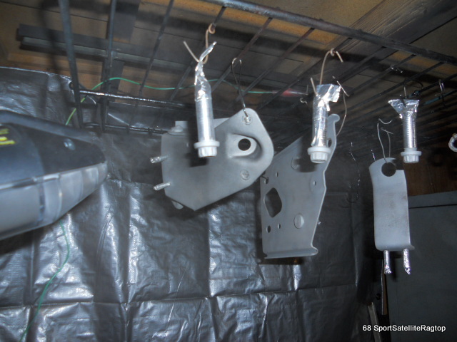

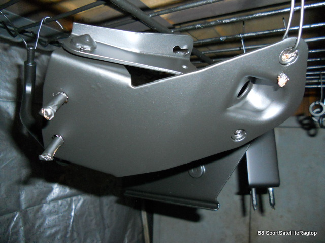

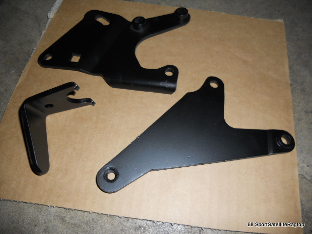

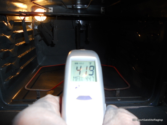

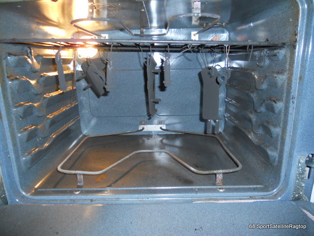

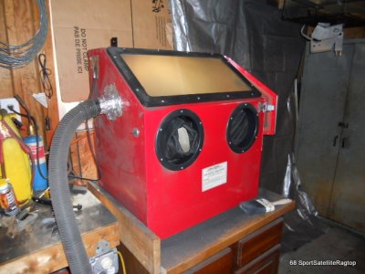

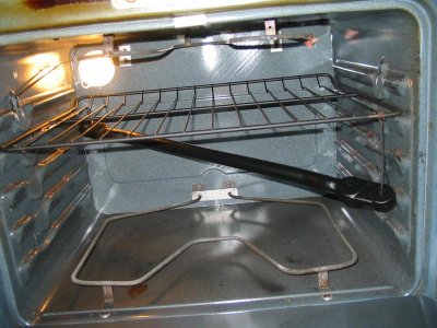

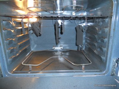

Curing the parts in the oven does create quite the stink! I don't know how much you were quoted for coating your parts but if you have the room and some time, doing it yourself is easy and you can achieve decent results. If it fits in your blast cabinet and oven, it ain't rocket science.
What's the deal with all you guys having an oven in your garage? I didn't realize that was a prerequisite for this addiction of ours.
Now I gotta start looking for a oven for my shop. Thanks alot!

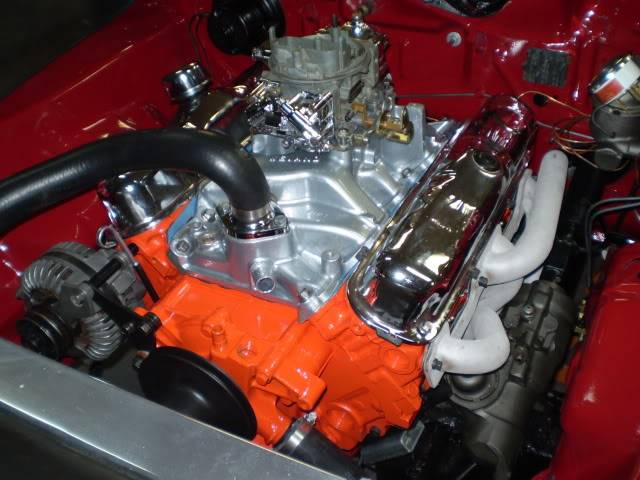

Nice work guys! When I had my 72 911 I had all the engine tin powder baked and it held up just fine - including the piece over the muffler.
