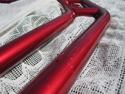

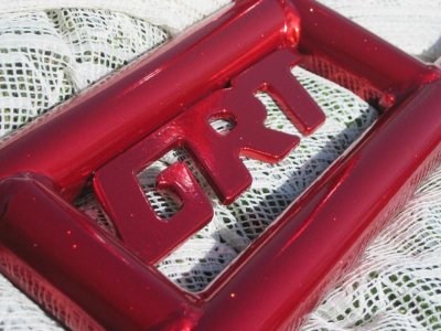

ragtop, I recall we talked about some work on your Satellite a couple years ago. Just for fun, I see your little black brackets and will raise you a few teasers just as an illustration of what can be done with powders :love5: ...
Finished! (6) - Copy.jpg016 - Copy.jpg072 - Copy.jpg010 - Copy.jpg019 - Copy.jpg042 - Copy.jpg039 - Copy.jpg027 - Copy.jpgget-attachment (4).jpgPost-assembly pic.jpg

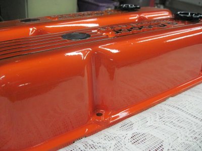

they look kick ***!! Leanna's work is top-notch!
she took what was in my head and put it on the VC's exactly how i envisioned it.
i will recommend her to anyone lookin' to do powder-coating!! ill put up a thread as soon as they arrive to me and i can install them on the olde GTX'er.
thanks again, Leanna!! you're da best!!
Mario, I'm delighted that you're happy with what you've seen so far! Thank you kindly for the wonderful comments sir < curtsey > Just wait though -- the pictures I sent you hardly do them justice. I can't wait to see them on your fine GTX ... and I'm sure with the way they turned out they'll be prominently featured in several places on my website.
Just one thing I have to clarify though: YOU'RE da best! :icon_lol: If it wasn't for you, I'd still be waiting for my first FBBO customer.

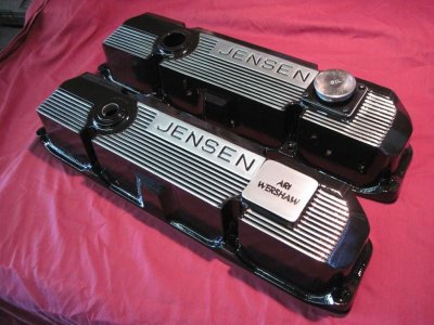

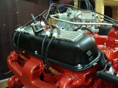

I wasn't gonna jump into this conversation, but I had to compliment the work in the photos posted above.
Very nice stuff.

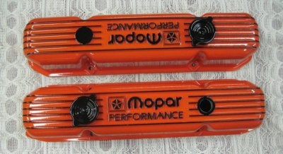

well, maybe a little tease...
That is some beautiful work. CudaChick, the extent of my work is what you see, one color, parts that are small and I would rather have coated than painted. Your work is top quality and if I wanted anything more then what I am comfortable with, I would contact you about your service. PS, I wasn't impling that anyone can do what you do, rather what I do!
Damn Leanna, those look INCREDIBLY AWESOME. :headbang:I thought my home painted vc's looked pretty good but I'm having second thoughts now. Well now that I'm going back to work maybe I'll be able to get some parts done :)

Oh nooooo fate and sporty, please don't EVER diminish or underrate your own work or fail to share what you know -- this is a DIY forum after all, and there's no such thing as too much information on any subject. The only disservice happens when it's the wrong information. Besides, we all have to start somewhere, and in my view no day is a success unless you learn at least one new thing.
Please understand I wasn't picking on you guys at all, just a bit of a teasing with the poker call, and wanted to show you and the others what could be possible with some imagination, patience and techniques. I'm sure northerndave and the others with lots of time in the industry will agree that we could all do nothing day in and day out except track down and try to correct all the misinformation and false rumors on the 'net about powder coating and never, ever ever be able to. Sometimes while reading forums I just cringe and have to pass it by just because there's 30 guys all tossing out "information" about things they know nothing about ... and sadly, there just isn't enough time in the day to set them all straight and help them with their projects. Like you, I enjoy sharing [some of hehh hehhhh] what I know too but I'll never consider myself an expert -- because there's always something else to try that ya didn't think of before.
Just ask MarPar about my initial evaluation of his truly wild 6-color valve cover idea -- it wasn't pretty at all. But after staring at them awhile and rethinking a few things, I figured out a plan to cut my masking time more than in half ... and even as my own worst critic I can't complain too much about the results on his big block MPs up there.
I really do appreciate your comments and want to extend a hand if there's ever anything I can help you guys out with as you continue to progress. Billy's on the phone almost constantly and my equipment's loud but I've got voice mail and can call ya back.

Those valve covers look absolutely fabulous. I have some M/T valve covers that need that kind of work done to them.
Leanna, thanks for comin by and clearin it all up. I wasn't aware powder coating was more more flexible. I guess that tells you all I've seen is crappy jobs. lol
Thank you! I've done a bunch of Mickeys over the years but most have been black and/or polished.
