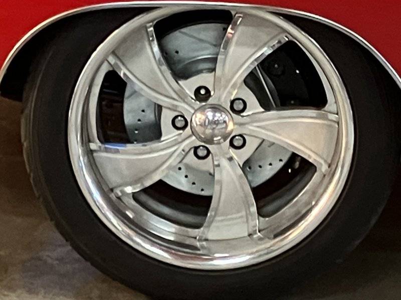

Dr Diff, AKA Cass Eslick sells some great stuff. You can choose stock based parts or complete kits or upgrade to bigger and better brakes. I went with 13" front kit that uses modified Ford Mustang rotors and calipers.
The 13" kit required the use of a 17" or larger wheel to clear the calipers but Cass has stuff that will fit under a 15" or even a 14" wheel.

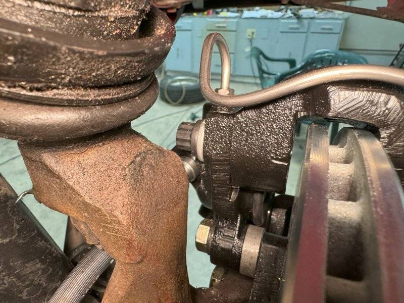

Sorry picks shows how the caliper is offset against the rotor. Rotor is true - hope these help
They do help. Like Darter6 said , reduce those shims by about 1/2. I'm surprised the instructions said nothing about setting the caliper distance. They do in wilwood kits. In a fixed position caliper its necessary. Sliding caliper, no
Looks like if you remove the spacer and replace with a thinner one you will be ok.
Yes I was thinking of that. Just getting clearance for the rotor the pads and pistons would still be offset in the caliper. My concern is with the caliper being offset would that create an uneven surface for pads against the rotor when braking or do you think the pads would just wear to take up the slack?
So is the issue that it's offset or not parallel?
Can't really tell from the picture.
If it's offset then you should be able to adjust the spacers.
If it's not parallel (crooked) then you've got to change parts somewhere.
The casting cleanup grinding does look pretty crappy.
Not quite sure what you mean, but if you look at your picture, the shims are making it offset already, but just the wrong amount. With the proper shim, it will be "set"

You might have a bent spindle.
It happens.
