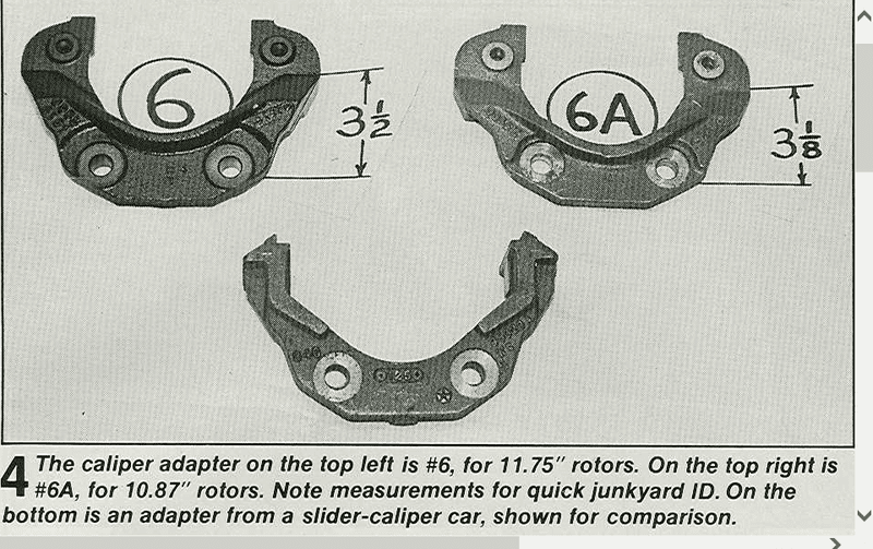

NEEDED
#6 Caliper adapters two p/n 3880557, 1976-78 B-body pin-type calipers for 11.75 Cordoba rotors.
Member @chignikred is in my neck of the woods and might have a pair but his inbox is full and I can’t leave a message, so hopefully he gets this.
