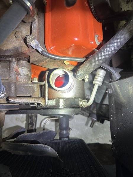

Took some pics, think I found leak. Looks like it’s coming from bottom of pump? I don’t see anywhere else, everything is clean. Also, this PS pump on this 66 charger engine has a vented cap, vs this aluminum looking one on mine. Is the vented needed? Also I guess PS fluid is just red cause it’s all red lol

I say that I had no leak prior to adding fluid btw. Think it was just low from installation. Also, I guess I should’ve added while running? Cause I had added it to the bottom of neck and after all the leak it’s still at neck
