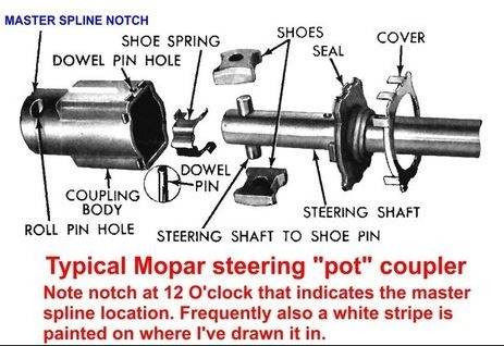

shoe spring.
it goes in the coupler between the column shaft and gearbox to hold the 2 shoes that clock the steering gear
Thanks, but that wasn’t it. I didn’t take any of that apart, plus the shim I found was flat, like a body shim. It was like a washer, but square and the hole opened up on one side.
