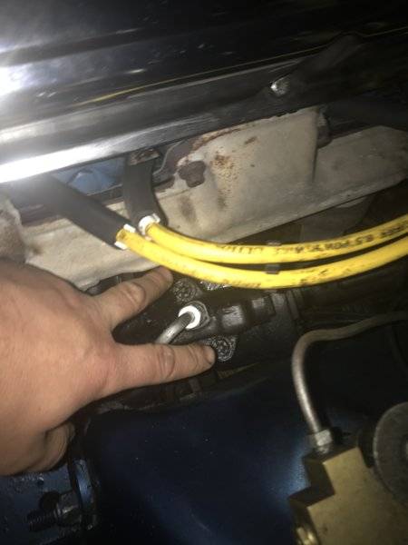

69 Coronet. Anyone ever change a 69 power steering gear box ? I changed the pump a couple of times recently. I cut down the leaking drastically. The gearbox itself is still leaking a little. But, I can’t decipher where. I know it’s the gearbox at this point because it throws fluid onto the starter.
What are those star bolts called and what size socket is needed to remove it ? I believe all I have to do is remove those 2 star bolts and loosen what looks like a Allen bolt on the column shaft.
Those who have fought getting these in and out. What is the easiest approach you’ve found. Starter removed ? Anything else ? And what is the best price you’ve found and where ?

Anyone rebuild one of these gear boxes lately or have pictures of what it looks like under this adaptor piece you could post ?
After a lot of observing it in the past year. I believe the majority of leaking is around this adaptor on the top held by two nuts. And there’s a triangular adaptor in the front of it that one hose is clamped to. I believe if I take those 2 adapters off and make my own gaskets. It very well may seal everything up, without take off or buying another gear box. It’s not leaking very bad. But, enough to piss me off, lol ! I have to add to the reservoir about every 5th-6th ime I take it for a drive. And sprays on my starter a little. I tried tightening the two nuts a few months ago.
The front return fitting and top valve block use rubber O-rings in machined grooves, not gaskets. I get them from a local hydraulic supply for about 25 cents a piece. There is a process for re-centering the steering outlined in the FSM, which often needs to be done after removing and re-installing the valve block.
Thank you, I hope to find it in the manual. Pretty sure, that’s the problem.
Make sure when you go to start it for the first time after messing with that valve you keep clear of the steering wheel until you get it properly adjusted.

I filled the pump with some Lucas power steering leak stop. Went on two drives totaling about 60 miles. Both days it was a little under 50 degrees. For the first time it never leaked a drop. But, we’ll see how it is when it’s much warmer. Big improvement considering how bad it leaked. I’m going to replace the o-ring seals on the valve body when it warms up.
