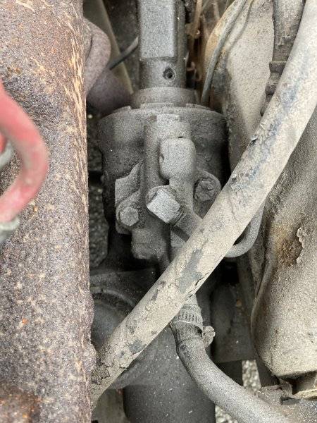

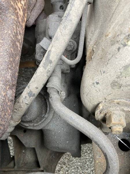

Is this the correct power steering hose on my 1968 Plymouth satellite. The car is a 273 small block car. I think it’s wrong because it’s rubbing on the exhaust manifold. Is the steering box correct too? I’m aware that they’re two types on these 68-70 b bodies. Please discuss below. Thanks
You got several things going on there. You do not use that 90 degree adapter on the gear box. And the hose looks to be correct but not installed in the right position.
I have seen some of the earlier 60's B-bodies use the 90° adapter for oem replacement hoses that are clocked to mount at a right angle in relation to the box. The original 68 hoses should have a U shaped bend to mount straight down onto the box. Your Saginaw pump looks like it uses a 2891109 hose originally. I believe that era mostly used the round fill tube Federal/TRW pumps. The hose definitely looks like a universal aftermarket piece. The original Federal hose ran straight down after the pump then with a u shaped bend came up to meet the top of the box, avoiding getting anywhere near the manifold.

The 90 degree is not common on B-Bodies unless you have a Hemi. The hose looks correct but it is bent back instead of a 90 at the pump.
Looks like the hose for a Federal pump car. but has a Saginaw pump

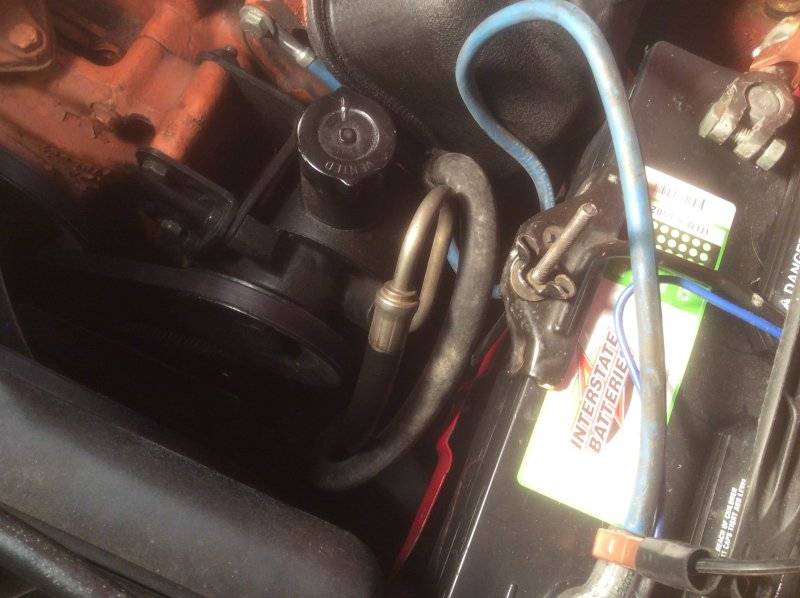

I used to have the same type of hose that the op has now and hated it because the 68 Federal style hose was so difficult to find and it's all that was available for many years. Finally located a correct one (2537981) several years ago. @dmoore has the 90° fitting on his perfectly restored 64 Sport Fury with the 426W.
It also looks like the top fitting on your coupler needs attention.

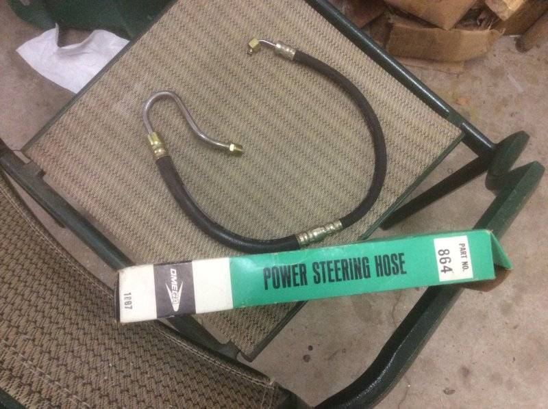

This is a correct replacement hose for mine. Loops underneath getting nowhere near the manifold. Did you order the hose from Rick?

He does not have that style pump and he also has the 90 degree fitting on the box which will not allow the correct routing or fitment. He needs the straight fitting.

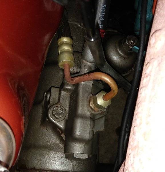

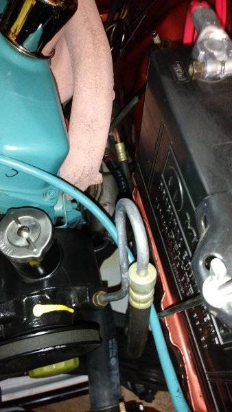

Is that a custom made or do you have a Manufacturer and part number? Can you post a picture of the steering box end? In car picture same hose.

Correct, which is why I provided a link to the correct Saginaw style hose. As stated, I have the correct hose for my particular setup. Replacement straight fitting shouldn't be difficult to find.
