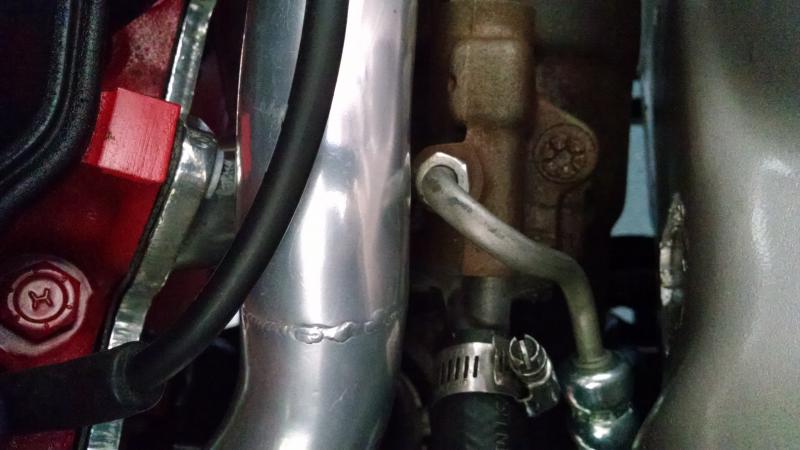

With front wheels off the ground, I started the car & ensured wheels were centered. Shut car off then removed distribution block. Changed out block & O-rings and re-assembled everything. Started car to see how I did. Wheels immediately turned hard right. Loosened the bolts enough to slide block fwd 1/8th"(?). Tightened bolts then restarted car. This time wheels went just left of center. (aft turns wheels right, fwd turns wheels left...had to figure that out by trial & error). Shut her down and tweeked it again. Eventually got it true to center.
Don't put the wheels on the ground until you can stop & start the car and have the wheels stay centered. Hopefully this makes sense and is helpful
Dako, I really appreciate the time you took to explain the process, including the excellent picture.
You're welcome. If you look close, you can see I marked mine (fender side of dist. Block) once it was set...I used a Sharpie.
