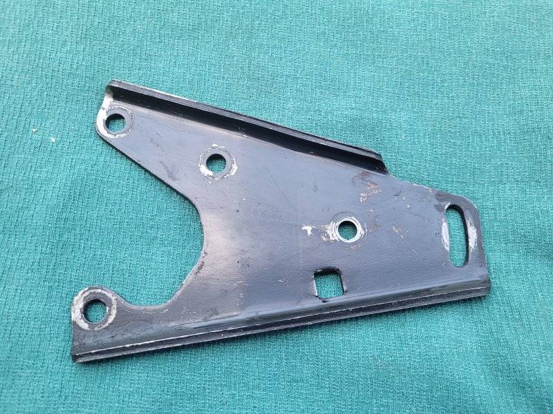

I wonder if one off an Aspen or Volare would work. I’d owned several over the years with power steering.
Any if these work for you? The last 3 pics are 2 pwr str brackets off 318

I should have a used p/steering pump that I removed from a 82-83 Dodge truck along time ago. I am selling it as a core, but it may work, IDK. Saginaw pump with brackets, and I should also have the original hardware too. I will try to look for, and check it out. Just let me know if you should still need.
