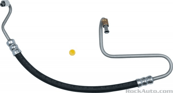

The pressure hose on the Coronet is sweating p/s fluid from the hose. Time to replace it, but all the rebops look cheap. I've checked out Ebay, RockAuto, YO, Classic Industries. The collar crimp is way different from the OEM.
OEM:
Rebop:
What have other members used when replacing the hose?

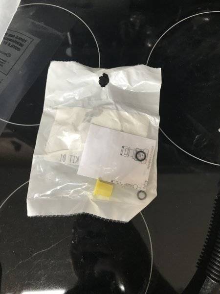

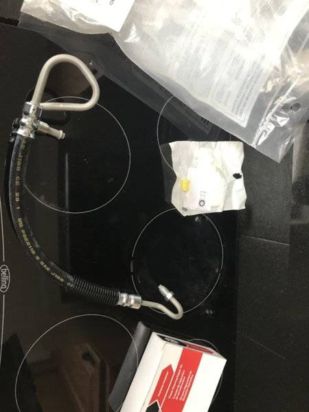

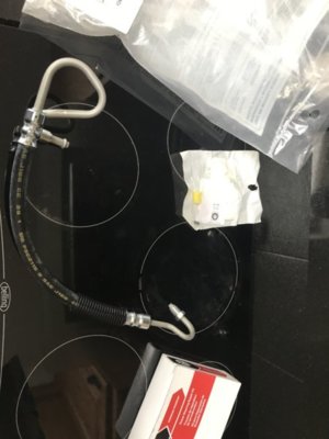

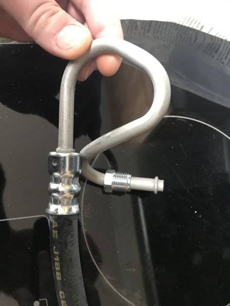

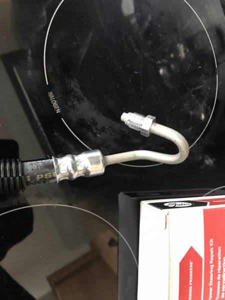

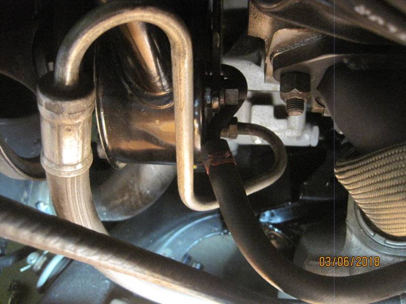

Ok well mine landed today, I ordered the pipe for the Federal pump which is on my engine the pipe is different than what’s on my car. My car was originally a 318, the 383 in it is a 68 so it’s unlcea if the pipe or pump where changed at any point. I’m not surprised really with my car, nithis is ever straight forward with it.I’ll offer it up later and see how it fits.
Here are some images of the pipe and how it came...

thanks for the pics. And actually, the hose fittings look really good, very close to OEM. More than likely, the low-res image in the online catalogs don't do the product justice.

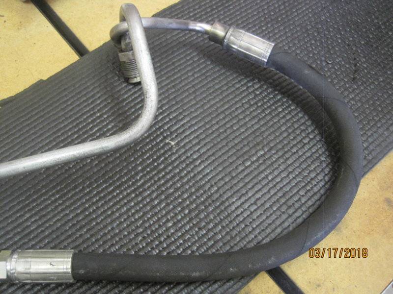

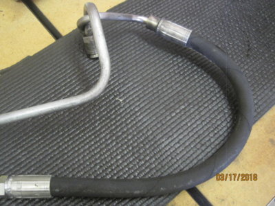

Decided to use a local hydraulic repair shop. Had to call four - the first three didn't do automotive because of the liability. Doesn't look exactly stock, but the crimps are vertical like the OEM instead of barrel shape. And the lowest rated hose they offer is 3000 psi; factory specs are 1050 psi, so it should be good for a while. Installed over the weekend and test drove about 50 miles and no leaks. On to the next project..
