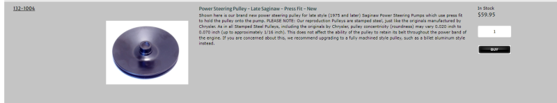

Maybe buy this and get a pump for a late model Impala?

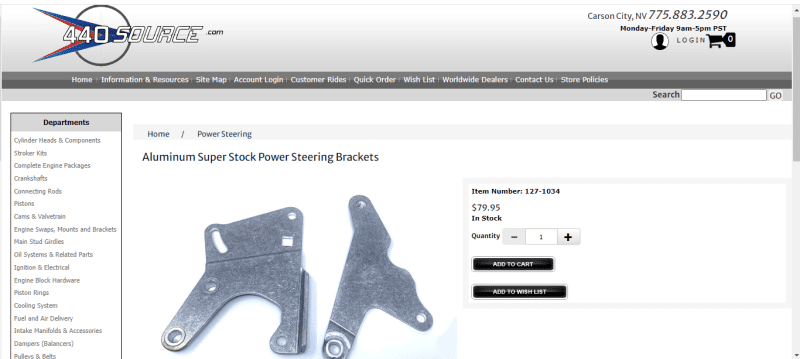

I just finished the VA installation on Dwayne's 68 Plymouth with a Saginaw. The pump and brackets were the same as I have on my '70 Charger. They are from a mid 70s big block, nothing exotic at all. Then there are THESE aluminum brackets...
