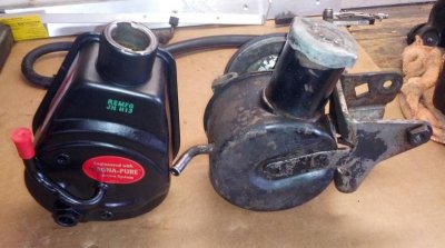

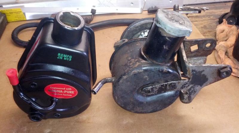

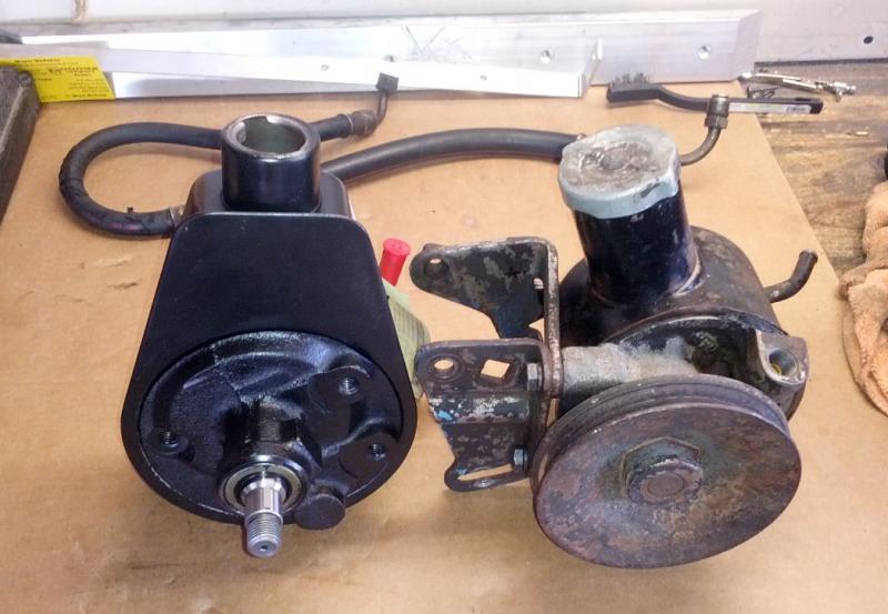

Well crap… I bought a new (rebuilt) power steering pump and I was not paying very close attention to details. Turns out the new one is completely different than my old one.
Any ideas on where I can pickup a mounting bracket, pump pulley and fluid cap for the new one? Suppose I could send the old one back, just checking my options.

Classic Industries and many other parts places have these brackets with all the bolts. Price is about $60 Not sure about the cap, but I'm sure these are available. The pulley is also sold separately. Ebay is also a good source.

You have a Thompson pump, not a Saginaw. I got an insert for my Thompson, not the entire pump from my local auto parts store. It was easy to change.

New pump with high pressure hose out back is Saginaw, old pump with solid shaft is small TRW/Thompson...
