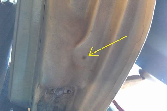

Locationing the correct position of the necessary holes for the original window harness shouldn’t be too much of a challenge as there are dimples locating them in both the jamb and door. The hole sizing is staggered however, with larger grommets molded to the harness at the jamb locations and larger sizes on the driver’s jamb/door than the passenger side.
What you may do on your completed car is pull the inner fender splash shields, that cover the hinge area. You may have a straight shot at the door for drilling and a possible right angle shot at the jamb from the front fender wells. Another option for accessing the jamb would be removing the dash frame and cutting the holes from the inside out.
I can get you some pics if you want. I have it all but pulled now-I popped the switch plugs apart and removed the harnesses through the holes a while back and have it laying in the car now. My switches are original, so yours are definitely nicer. I'll send you a PM with my email address so we can talk about it offline. The fenders are off the parts car now, but I can rehang them to see if the holes can be drilled with fenders in place and splash shields out if that will help you too.
