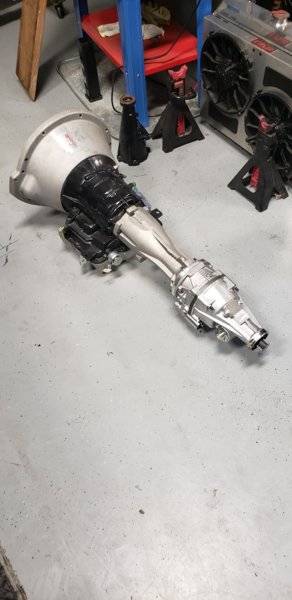

Powerglide to replace my Torqueflite
Almost ready. Sent the driveshaft to the driveline shop to be shortened about 6inches . I also have a promod gearvendors on it.

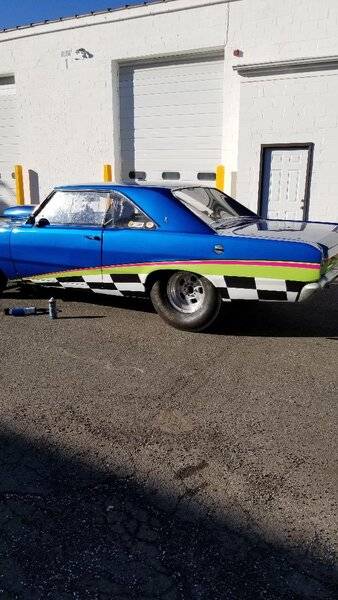

Well I finally got to to the track with my car after swapping in the powerglide. I lost 2 hundreths in the 60ft but identical 1/8 et and mph footbraking.I will try the trans brake next time out.
Only was able to make 1 run on Friday because of the amount of people. Checked plugs look ok, red lite 1st time with trans brake. Went straight , wasn’t trying for fast pass just wanted to make sure things are good for next time.
